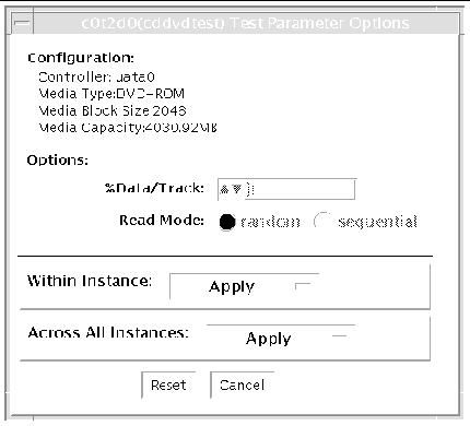

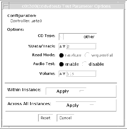

CD-ROM Test Options
FIGURE 5-1 cddvdtest Test Parameter Options Dialog Box for CD-ROM
TABLE 5-2 cddvdtest Options for CD-ROM
Option
Description
CD Type
The types of compact discs that can be tested are listed in the CD Type menu. The choices are: pdo, multi-session, or other the default CD type is other). In the Connection test mode, this option has a default value of other.
Note - Your choice must correspond with the disc ussed for testing.
% Data/Track
Tests a percentage of data on each track. Type a value between 0 and 100 in this field to indicate the percentage. In the online and connection tests this option has a canned value of 2%.
Read Mode
cddvdtest reads the CD either in Random or Sequential mode. In Random mode, data blocks are read from random track positions; in Sequential mode, data blocks are read in sequence. For both modes, the total number of blocks read is determined by the %_of_data option. In the online and Connection tests this option has a canned value of random.
Audio Test
Enables or disables the audio test. You must connect headphones or a speaker to the audio jack on the CD player to hear audio output. In the Connection test, this option has a default value of disable.
Volume
Adjusts the volume. Type a value between 0 and 255 in this field. In the online and connection tests this option has a default value of 125.
DVD-ROM Test Options
FIGURE 5-2 cddvdtest Test Parameter Dialog Box for DVD-ROM
TABLE 5-3 cddvdrwtest options for DVD-ROM
Option
Description
% Data/Track
Specifies a percentage of data to test for each track.
Use a number between 0 and 100.
Read Mode
Specifies either Random or Sequential mode. Random mode reads data blocks from random track positions. Sequential mode reads data blocks in sequence. For both modes, the total number of blocks read is determined by the % Data/Track value.

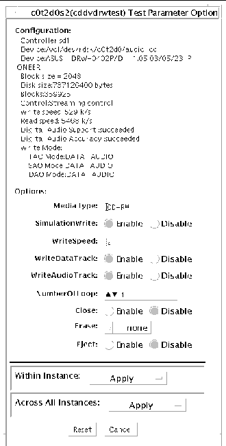

CD-RW Test Options
FIGURE 5-3 cddvdtest Test Parameter Options Dialog Box for CD-RW
TABLE 5-4 cddvdtest Options for CD-RW
Option
Description
SimulationWrite
Disable/Enable Simulation Write
WriteSpeed
Speed entered in terms of nX. Speed will be set to closest approximation of nX allowed by device.
WriteDataTrack
Write a Data Track in one Test Loop
WriteAudioTrack
Write an Audio Track in one Test Loop
NumberOfLoop
Number of loop in one test pass comprising Data and Audio Track if enabled.
Close
Close after writing. Can not write more track on media.
Erase None
No erase All: Erase whole disk
Eject
Eject the disk when test completed. Do not enable this option in a multiple pass test session.

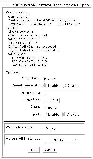

DVD-RW Test Options
FIGURE 5-4 cddvdtest Test Parameter Options Dialog Box for DVD-RW
TABLE 5-5 cddvdtest Options for DVD-RW
Options
Description
SimulationWrite
WriteSpeed
Speed entered in term of nX. Speed will be set to closest approximation of nX allowed by device.
ImageSize
Track Size, how much data is written: 2MB, 10MB, 2GB, 4GB
Erase None
No erase
Fast
Erase with "fast" option. Only Table of Content is erased
All
Erase with "all" option. Erase whole disk surface.
Eject
