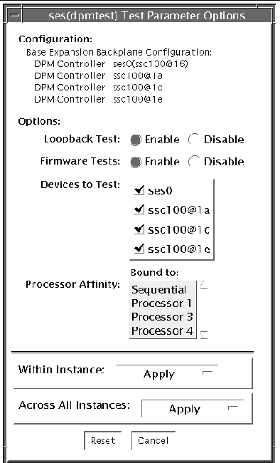

FIGURE 11-1 dpmtest Test Parameter Options Dialog Box
Screenshot of the dpmtest Test Parameter Options dialog box.

Firmware Test
When enabled, the subtest runs the system friendly firmware tests on each of the selected SES/SSC100 devices. By default it is enabled.
Loopback Test
When enabled, the subtest will cause the SES device to loop packets around the fiber loop with varying data patterns. The device reads the packet after the packet is received, and verifies that the data payload is correct. By default it is enabled.Note: This test will run only on SES/SSC100 devices which are in the base backplane.
Devices to Test
The SES/SSC100 devices being tested. Users have an option to select or deselect each device for being tested. By default all the devices are selected for testing.Note: At least one device has to be selected for testing. If the user tries to deselect all of the devices, then an error message will be popped up.Note: If the device has both fibre and i2c paths, only the fibre path is listed under 'Devices to Test'. When you perform the tests on this device, the tests are run on both fibre and i2c paths.
