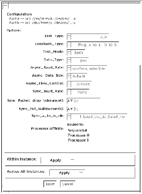

To reach the dialog box below, right-click on the test name in
the System Map and select Test Parameter Options. If you do not see this test in the System Map, you might need
to expand the collapsed groups, or your system may not include the device appropriate to this test. Refer to the
SunVTS User's Guide for more details.
FIGURE 46-1 serialtest
Test Parameter Options Dialog Box
TABLE 46-1
serialtest Options
Option
Description
Test Type
Selects how the test will run. Test options include:
a = runs the test on port a
b = runs the test on port b
a_b = runs the test on ports a and b
sequentially
a_b_concurrent = runs the test on port a
and port b concurrently.
Loopback Type
Selects the loopback test. Options include:
Internal is an internal path for a, b,
a_b, and a_b_concurrent test types.
Plug_a_to_a__b_to_b is an external
loopback plug for a, b, a_b, and a_b_concurrent test types.
no_modem_a_to_b is an external loopback
cable for a_to_b and a_to_b_concurrent test types.
Modem_a_to_b is an external loopback
cable with a modem attached to generate synchronous Transmit and Receive clocks in synchronous mode. The modem
a_to_b external loopback type is intended for Sun internal use only. It requires custom equipment that is not
available. (Supported only for SP devices.)
Data Type
Selects the data pattern to transfer. The user can select:
- Random
- Sequential
- Alphanumeric
- 0x00-0xff
Async Baud Rate
Selects the baud rate for Asynchronous mode testing. The valid
rates are: 110, 300, 600, 1200, 4800, 9600, 19200, 38400, 57600, 76800, 115200, 153600,
230400, 307200, 460800, and "ALL". The default rate is 9600 baud. Some
platforms can only support up to 38400 or 76800. If the device is connected to the super I/O port then the max
baud rate supported is 115200. The test will return an error if you try to use a higher baud rate than
is supported. For baud rates greater than 153600 the serial line drivers must be set for
RS-423 mode and not RS-232 mode. The RS-423 and RS-232 modes are usually selected by a
hardware jumper on the motherboard.
Consult your hardware installation
manual for more information.
Async Data Size
Selects the total number of bytes to transfer in Asynchronous
mode. This can range from 1 to 10000.
Async Flow Control
Selects the type of flow control to use in asynchronous mode
testing. The user can select Hardware (RTS/CTS), Software (XON/XOFF) or None. The default
depends on the loopback type. Software flow control is not allowed on a, b, a_b, or
a_b_concurrent loopback types.
The following options are not available for the devices
connected to the super I/O port. They are available for all other supported I/O ports.
Test Mode
Selects the mode to run the test in. The modes available are
Asynchronous, Synchronous or Both. When Both is selected, the test runs first in
Asynchronous mode then Synchronous mode.
Sync Baud Rate
Selects the device generated clock rate for
synchronous mode testing. The valid rates are from 110 to 230400. The rate does not have
to be a specific value as required for async mode baud rates. The default rate is 9600.
Some platforms can only support up to 38400 or 76800. The test will return an error if you try to use a higher
rate than is supported. For rates greater than 100000, the serial line drivers must be set for RS-423
mode and not RS-232 mode. The RS-423 and RS-232 modes are usually selected by a hardware
Sync Packet
Selects the tolerance level of Synchronous mode
dropped packets during the many_packets subtest. The default is Drop 20 percent. The valid
range is from 0 percent to 99 percent. Some packet drops are expected especially at higher Toleranceclock rates
and on a heavily loaded system.
Sync Poll Wait
Selects the number of seconds in additional time
to wait for a Synchronous mode packet to be sent. Additional time may be needed when there is
heavy system activity and time-outs are being detected. In general, the user can decrease
the value to 0 when the system load is light or increase the value when there is a heavy system load.
The following option is available only for devices connected to
the super I/O port. They do not apply to any other supported I/O ports.
User Defined Baud Rate
Allows the user to set
new baud rate values for the test. First select the User Defined option from the Async menu. Then enter the new
value in the User Defined Baud Rate field.

set for RS-423 mode and not RS-232 mode.
S=async_data_size
Asynchronous mode total number of bytes to write; from 1 to
10000 bytes.
par=none|even|odd
Parity used in the async loop test. Default value is none.
BS=1|10|100|1000|3000|5000|10000
Number of bytes in each write during async loop test. Default
value is 100.
F=flow_control
Asynchronous mode flow control:
- Hardware (RTS/CTS)
- Software (xon/xoff)
- None
B=sync_baud_rate
Synchronous baud rate (default = 9600). The valid rates
are between 110 - 256000.
Note: Some platforms can only support synchronous rates up to
38400 or 76800. For rates greater than 100000 the serial line drivers must be set for
DP=sync_drop_tolerance
Synchronous mode drop packet tolerance (default=20 percent).
P=sync_poll_wait
Synchronous mode additional wait time during poll (in seconds).
UAB=User_Baud_Rate
The user can specify any valid baud rate. To do this, AB should
be set to "u".
