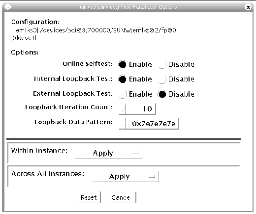

To reach the following dialog box, right-click on the test name in the System Map and select Test Parameter Options. If you do not see this test in the System Map, you might need to expand the collapsed groups, or your system might not include the device appropriate to this test. Refer to the SunVTS User's Guide for more details.
FIGURE 14-1 emlxtest Test Parameter Options Dialog Box
The following table lists the test parameter options for emlxtest.
TABLE 14-1 emlxtest Options

Online Selftest
Evaluates the functionality of ISP hardware by performing the following tests:
- Transmit FIFO test
- Receive FIFO test
- SRAM test
- Misc. Register tests
Run by default, but can be deselected.
Internal Loopback Test
Performs internal loopback test within the host adapter ISP hardware at the interface. This test is done with data sourcing from the system memory and going to the system memory. The desired data pattern, transfer length, and iteration count can be selected with the test parameters menu. Run by default, but can be deselected.
External Loopback Test
Performs an external loopback test. This test is performed with data sourcing from the system memory and going to the system memory. The desired data pattern, transfer length, and iteration count can be selected via the test parameters menu. This is an intervention test, because a loopback cable is needed from the transceiver to the receiver of the Emulex port when testing this port by itself. This subtest can also test the entire fibre channel loop when the loop is connected to the storage to be tested. Not run by default, but can be selected.
Loopback Iteration Count
Sets the number of times to loop the internal 10-bit, internal 1-bit, and external loopback tests. Default value is 10.
Loopback Data Pattern
Selects the data pattern to loop for the internal 10-bit, internal 1-bit, and external loopback tests. Default value is 0x7e7e7e7e.
