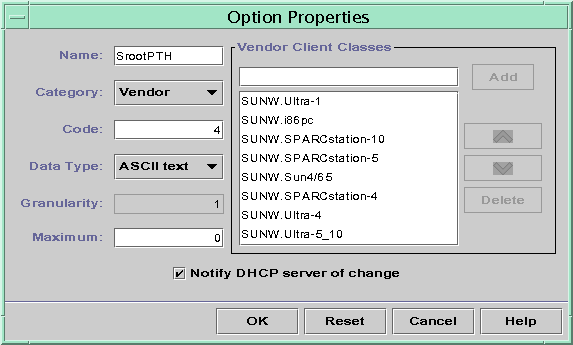

The following figure shows DHCP Manager's Option Properties dialog box.
Figure 14-18 Option Properties Dialog Box in DHCP Manager
See How to Start and Stop DHCP Manager for information about DHCP Manager.
The Option Properties dialog box opens.
See Table 14-5 for information about the properties, or view the DHCP Manager help.
The change is made to the dhcptab table. The DHCP server is signaled to reread the dhcptab table to put the changes into effect.
