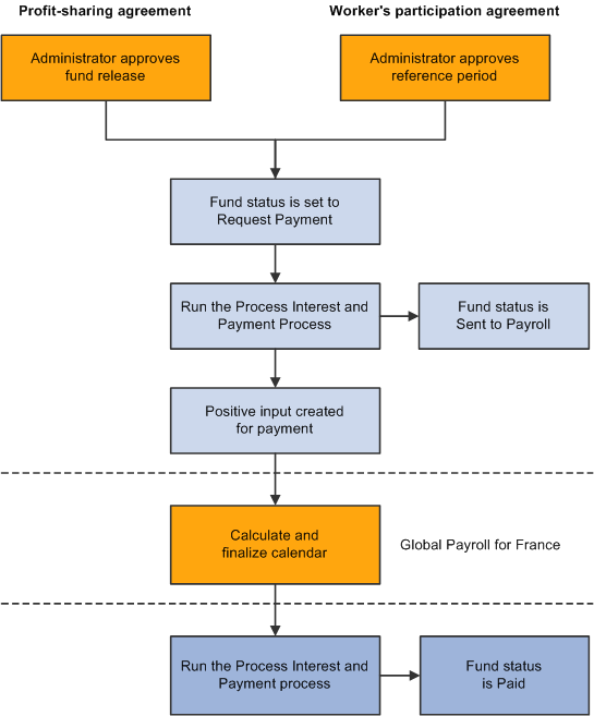

Processes payments for profit-sharing funds with Company Investment as the investment method and worker's participation funds with Employee's Bank Account as the investment method.
Payments are processed only if the reference period is Approved and the fund status is Request Payment. The process changes the fund status to Sent to payroll.
Receives information from Global Payroll for France or another payroll system about the status of payments previously sent, and updates fund status accordingly.
Payments that were processed successfully are assigned a status of Paid. If a payment was not processed, the process changes the fund status to Error.
Workflow occurs when the Process Interest and Payment process updates employees' fund status to:
Available or Paid, which triggers an email to employees informing them that their funds are available or paid.
Error, which triggers an email to the compensation administrator who must investigate the error.
See Setting Up Workflow for Profit Sharing.
Integrating with Global Payroll for France
If you installed Global Payroll for France, you can use it to automatically process payments. The following diagram illustrates the payment processing with Global Payroll for France:
Overview of payment processing

To integrate the Manage French Profit Sharing business process with a payroll system other than Global Payroll for France, you must set up the integration points that enable payment information to be exchanged.
See Interactive Services Repository in the Implementation Guide section on My Oracle Support.

Page Used to Run the Process Interest and Payment Application Engine
Process (HR_WP_PAYMT)|
Page Name |
Definition Name |
Navigation |
Usage |
RUNCTL_WP_PAYMT |
Compensation, Profit-Sharing FRA, Compute Profit-Sharing, Process Interest & Payment, Process Interest & Payment |
Run the process for a selected agreement and reference period. |
Running the Process Interest and Payment Application Engine Process
(HR_WP_PAYMT)
Access the Process Interest & Payment page (Compensation, Profit-Sharing FRA, Compute Profit-Sharing, Process Interest & Payment, Process Interest & Payment).
