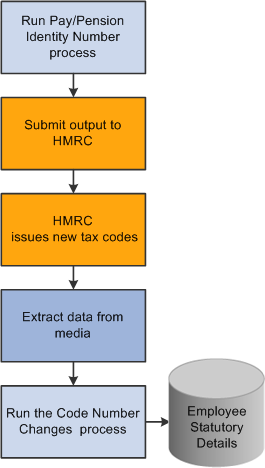

This diagram illustrates how the Pay/Pension Numbers and Code Number Changes processes enable you to submit information to HMRC and receive updated tax codes electronically:
Process for updating tax codes
The Code Number Changes process is discussed in an earlier chapter.
