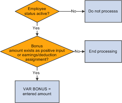

Global Payroll for China delivers the VAR BONUS earning as an example of how to enter variable bonus pay for your payees.
VAR BONUS is a fixed amount earning entered through positive input.
No proration is associated with VAR BONUS.
This diagram illustrates the process flow for the VAR BONUS earning:
Process flow for VAR BONUS earning
