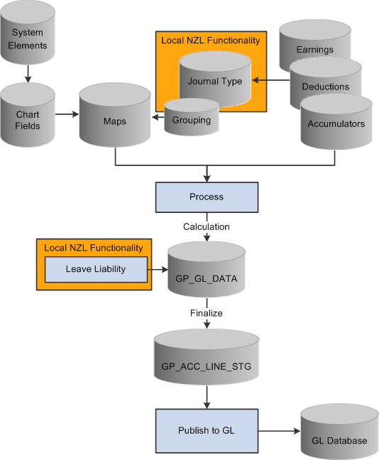

The following diagram represents the processing of payroll data for the GLI and highlights the added local functionality. Note that the Leave Entitlement option updates data in the GP_GL_DATA table for inclusion in the output to the GLI.

Running the GLI Processes
The Calculate phase of GLI processing populates the GP_GL_DATA table. The Leave Entitlement process uses the Application Engine program GPNZ_LV_LIAB to compare previous entitlement liability to current entitlement liability and load the difference into GP_GL_DATA. After you have updated the GP_GL_DATA table, you can complete the standard core GLI process by running Finalize.
You can also run an Application Engine process (GPNZL_GL_MAP) that updates ChartFields in GP_GL_DATA. The program selects and updates the necessary GP_GL_DATA records with specified ChartField overrides. When you run the GL interface finalize process, the data is summarized using your chosen (remapped) ChartFields for correct account mapping.
Note. You need to have already finalized your payroll to get up-to-date entitlement balances—upon which the liability calculation is based—for annual leave.
