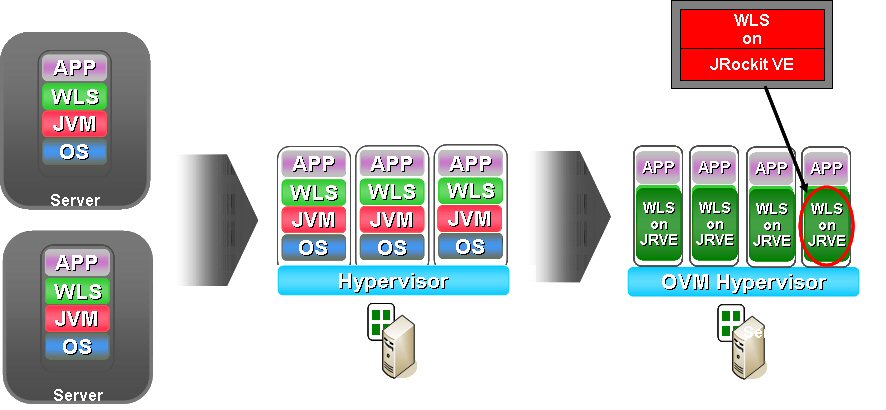

JRockit Virtual Edition integrates functionality normally found in operating systems, as such replacing the role of a guest OS in a VM image; therefore, each VM image containing JRockit Virtual Edition and WebLogic Server only executes a single Administration or Managed Server instance. Multiple VM image instances may be combined either on a single physical server, or across several such servers to model traditional physical deployments of Multiple Managed server instances sharing the same OS instance on a physical server.
WebLogic Server on JRockit VE includes an Image Tool (wlsveimagetool.jar) that provides full access to a VM image's file system, on a guest machine running a Linux OS. With the Image Tool, you can configure and modify non-running virtual machines, including the ability to create, read, update, and delete user application files, as well as change virtual hardware parameters and modify the default disk size. You can also use the Image Tool to modify the Java arguments for the WebLogic Server start-up command in the VM image configuration file.
The Image Tool requires having the Java Runtime Environment (at least JDK version 6) installed on your development Linux machine. The Image Tool is an offline manipulation tool for existing virtual machines. You should not attempt to apply it to virtual machines whose file systems are mounted or in use.
Use of the Image Tool for physical-to-virtual WebLogic Server domain migrations is not supported on Windows platforms.Figure 1-1 illustrates how WebLogic Server on JRockit VE fully utilizes the potential of server virtualization for Enterprise Java Applications by delivering management simplicity with improved performance and better utilization.
Figure 1-1 How WebLogic Server on JRockit VE Utilizes Server Virtualization
