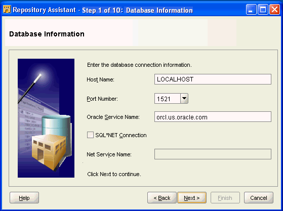

On the Database Information page, enter the host name, port number, and service name where OWB is installed.
Click Next.

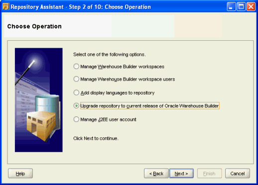

On the Choose Operation page, select Upgrade repository to current release of Oracle Warehouse Builder.
Click Next.

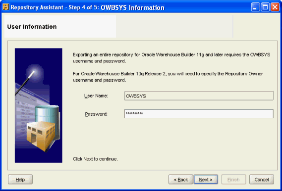

On the OWBSYS Information page, enter the password for the OWBSYS user.
Click Next.

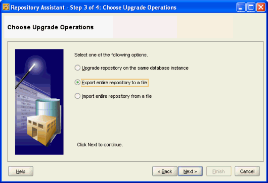

On the Choose Upgrade Operation page, select Export entire repository to a file.
Click Next.

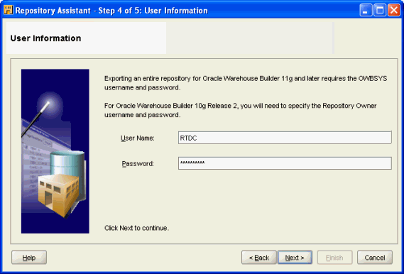

On the User Information page, for an OWB release 10.2 source, enter the user name and password of the OWB release 10.2 repository owner. For an OWB release 11.1 source, enter the OWBSYS user name and password.
Click Next.

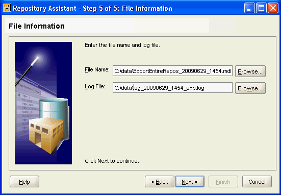

On the File Information page, enter the following information:
File Name: the name of the MDL file for storing the repository.
Log File: the name of the export operation log file that stores status and statistical information.
Click Next.

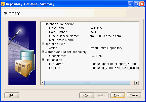

On the Summary page, click Finish.
An Export Repository Progress window appears showing progress.
At the end of the export process, a status message appears. The export operation creates the file.

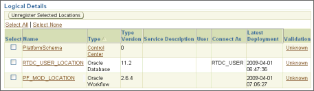

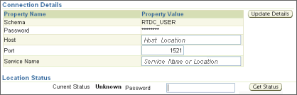

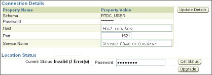

The locations in your OWB repository must also be upgraded for compatibility with OWB 11.2 after the upgrade process. There are two ways to perform this upgrade:
Use the script provided with OWB release 11.2.0.2 or higher. (This is the simpler procedure and is recommended.)

To upgrade locations using the Repository Browser

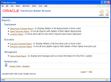

In Repository Browser, select Control Center. Click Reports.
In the Reports window, under Deployment, click Locations Reports.
On the Locations Report, under Logical Details, in the Validation column of the table, click Unknown.
Under Connection details, under Location Status, because the status is Unknown, enter the password and click Get Status.
Note that the Current Status is Invalid.
Under Location Status, click Upgrade.
Note that the Current Status is now Valid.
Once you are finished, notice that the Validation column shows Tested locations
