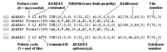

Testing the Adabas Data Source
Set the debug environment generalTrace parameter to true to generate entries in the standard log racing the access to Adabas data.
See Also:
Setting Up an Adabas Data Source for information on how to add a data source.
Figure 10-1 Adabas Log Entry Format
This image shows the Adabas log format
Description of "Figure 10-1 Adabas Log Entry Format"
