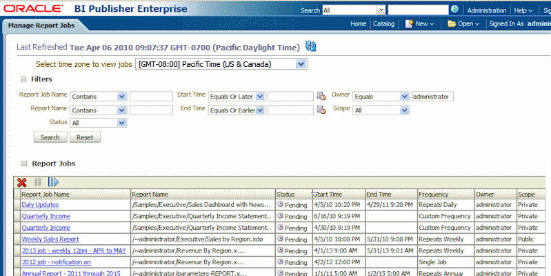

The Manage Report Jobs page displays information about future scheduled and recurring report jobs and enables you to take actions on these jobs. You can access this page and then search for the report jobs to manage; or, you can access this page from the context of a specific report.
To search for jobs to manage, navigate to this page as follows:
From the Home Page: Under Browse/Manage click Report Jobs

The following figure shows the Manage Report Jobs page:

If you navigated to the Manage Report Jobs page from the context of a specific report, the jobs for that report will be automatically display in the table with the following default filters applied:
Report Name - equals the name of the report from which you launched the Manage Report Jobs page
Owner - equals your user ID
Scope - equals All (public and private jobs)
Status - equals All (active and suspended jobs)
Use the following procedure to further filter the results.
Enter values for the Filter criteria to search for a specific job or group of jobs.
Click Search. The jobs that meet the filter criteria will be displayed in the Report Jobs table.
The table displays general information about the job as well as the status.
You can sort the table by a particular column by clicking the column heading and selecting the up arrow or down arrow for ascending or descending.
