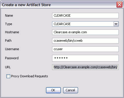

Click Add. The Create a New Artifact Store dialog is displayed, as shown in Figure 2-1.
Fill in the appropriate information, as shown in Figure 2-1.
Figure 2-1 Create a New Artifact Store Dialog
Click OK.

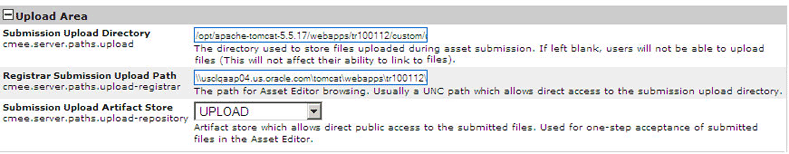

This procedure is performed on the Oracle Enterprise Repository Admin screen.
Click System Settings.
Enter cmee.server.paths.upload-repository in the Search box, as shown in Figure 2-2.
The Upload Area section within the Server Settings section is displayed, as shown in Figure 2-3.
Use the Submission Upload Artifact Store list to select the ClearCase repository.
Click Save when finished.

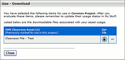

Click Use/Download. The Use - Download page is displayed, as shown in Figure 2-5.
ClearCase files should be available for download along with the asset.

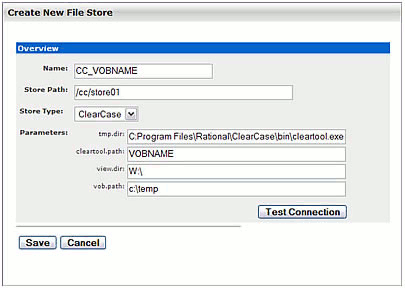

Click Create New to create a new File Store. The Create New File Store dialog is displayed, as shown in Figure 2-6.
Populate the fields with the following parameters:
Name: specify a representative name for the ClearCase VOB referenced by the File Store. The CC prefix is recommended to indicate that the File Store is of type ClearCase. Recommended protocol for the File Store name is CC_VOBNAME.
Store Path: enter /cc/store01 for the first ClearCase File Store, /cc/store02 for the second ClearCase File Store, and so on. The Store Path field is a symbolic path in Oracle Enterprise Repository. All File Stores use a common URL for file extraction. The Store Path appears in the URL, indicating which File Store hosts the integration to the actual content. The Store Path must be unique across all File Stores. The construction /cc/store01 is recommended.
Store Type: select ClearCase from the list.
cleartool.path: enter the entire file path to the cleartool.exe file on the application server.
vob.path: enter the name of the ClearCase VOB mounted in the view on the application server.
view.dir: enter the access path for the ClearCase view on the application server.
tmp.dir: enter the temporary directory on the application server.
Click the Test Connection button to test the connection to the ClearCase client. If the connection is properly configured, then the message Test Succeeded appears.
Click the Save button to save the File Store for use with Artifact Stores.

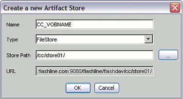

Select Configure Artifact Stores on the Actions menu. The Configure Artifact Stores dialog is displayed.
Click Add. The Create a New Artifact Store dialog is displayed, as shown in Figure 2-7.
Figure 2-7 Create a New Artifact Store Dialog
Enter a name for the artifact store. CC_VOBNAME is the recommended protocol.
In the Type list, select FileStore as the Artifact Store type.
FileStore accesses the list of File Stores created on the Oracle Enterprise Repository Admin screen.
Enter a Store Path by clicking on the Elipses button (next to the Store Path field) and selecting the name of the File Store to be used by this Artifact Store.
When finished, click OK. A separate Artifact Store must be created for each File Store.

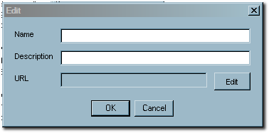

Click the Add button in the File Information section on the Overview tab.
In the dialog enter a name (and description, if necessary).

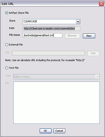

Click Edit. The Edit URL dialog is displayed.
Click the Artifact Store File option.
From the Store list, select the repository for the File Store (CC_VOBNAME).

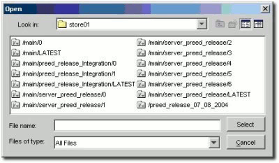

Next to the File Name box, browse the ClearCase repository.
When browsing, the top-level branches in the VOB. Select a branch. The branchname format is Branchname/Version. The version LATEST refers to the information that is currently checked in. Generally the highest number before LATEST is the desired version. In the image below, /main/server_preed_release/6 is version six of the branch /main/server_preed_release. The name in the folder area (store01) refers to the Store Path for the designated File Store.
The second level displays the folders within the selected Branchname/Version pair.
The third level displays the versions of the selected folder.
Subsequently, every selected folder is followed by a desired version. The last two browsed levels are:
The selected filename
The version of that file
The Select button populates the File Name field on the Edit URL window.
Click View to test the URL.

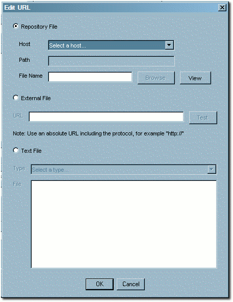

Click Add in the File Information section. The Edit dialog is displayed, as shown in Figure 2-10.
Click the Edit button. The Edit URL dialog is displayed, as shown in Figure 2-11.
In the Edit URL dialog, select Repository File.
Select a file store from the Host list.
Click Browse to locate a file, or enter the filename in the File Name text box.
Click View to view the file.
Click OK when finished.

In the dialog, enter a name and description, if necessary.
Select the Artifact Store File option.
From the Store list, select ClearQuest Repository.
Click the Browse button (next to the File Name box) to edit a ClearQuest shortcut.
Click the button to Launch ClearQuest Web interface and create a shortcut to a ClearQuest resource.
In the ClearQuest Web interface use the Operation -> Create a Shortcut link to run the wizard to generate a shortcut in ClearQuest.
Copy and paste everything following the question mark (?) in the resulting shortcut to the Launch ClearQuest Web shortcut screen.
Click OK to populate the File Name with the shortcut portion.
This should open the ClearQuest interface to the resource to which the shortcut was assigned.
