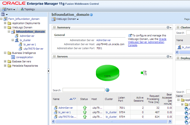

2.2.3 Using Fusion Middleware Control to Monitor Status and Start and Stop Oracle Business Intelligence Java Components
Use this topic to display the WebLogic Domain page, where you can monitor status and start and stop Oracle Business Intelligence Java components (Administration Server and Managed Servers).
You can also display the WebLogic Server Administration Console (using a link on the bifoundation_domain Summary page), where you can manage Oracle Business Intelligence Java components.
To manage Oracle Business Intelligence Java components using Fusion Middleware Control:
  1. Log in to Fusion Middleware Control.
    For more information, see Section 2.2.1, "Logging into Fusion Middleware Control to Manage Oracle Business Intelligence."
  2. Expand the WebLogic Domain folder and select the bifoundation_domain node.
    Fusion Middleware Control displays the bifoundation_domain page, as shown in Figure 2-4.
    Figure 2-4 Home Page for bifoundation_domain
    Fusion Middleware Control BI Domain Home page
    Description of "Figure 2-4 Home Page for bifoundation_domain"
    The bifoundation_domain page is the starting point for monitoring status and for starting and stopping Oracle Business Intelligence Java components using Fusion Middleware Control. You can also click a link to display the WebLogic Server Administration Console, where you can manage and configure Oracle Business Intelligence Java components. For more information, see Section 2.3, "Centrally Managing Oracle Business Intelligence Java Components Using the Oracle WebLogic Server Administration Console."
  3. Using the bifoundation_domain page, you can perform the following Oracle Business Intelligence management tasks:

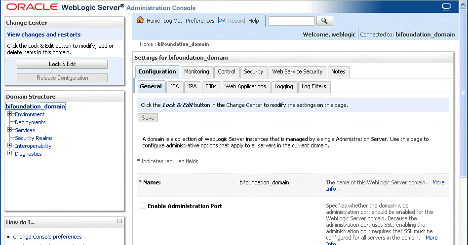

2.3 Centrally Managing Oracle Business Intelligence Java Components Using the Oracle WebLogic Server Administration Console
You use the Oracle WebLogic Server Administration Console to centrally manage Oracle Business Intelligence Java components.
You display Oracle WebLogic Server Administration Console, using the following methods:
  • Clicking a link on the Overview page in Fusion Middleware Control
  • Entering a URL into a Web browser window
The Oracle WebLogic Server Administration Console is available only if the Administration Server for WebLogic Server is running. For information, see Section 4.1, "About Starting and Stopping Oracle Business Intelligence."
To display Oracle WebLogic Server Administration Console:
  1. If the Administration Server for WebLogic Server is not running, start it.
    For information, see Section 4.7, "Starting and Stopping the Administration Server and All Oracle Business Intelligence Java Components on Windows and UNIX."
  2. Display the Oracle WebLogic Server Administration Console using the following methods:
    Clicking a link on the Overview page in Fusion Middleware Control:
    1. Display Fusion Middleware Control. For information, see Section 2.2.2, "Using Fusion Middleware Control to Manage Oracle Business Intelligence System Components."
    2. Expand the WebLogic Domain node and select the bifoundation_domain.
    3. Click the Oracle WebLogic Server Administration Console link in the Summary region.
      The Oracle WebLogic Server Administration Console login page is displayed.
    Using a URL in a Web browser window:
    1. Start a Web browser.
    2. Enter the following URL into the browser:
      http://<host>:<port>/console/
      For example, http://mycomputer:7001/console/
      where host is the DNS name or IP address of the Administration Server and port is the listen port on which the Administration Server is listening for requests (port 7001 by default). If you have configured a domain-wide Administration port, then use that port number. If you configured the Administration Server to use Secure Sockets Layer (SSL), then you must add the letter 's' after http as follows:
      https://<host>:7001/console/
      The preceding URL example uses SSL.
  3. Enter the system administrator user name and password and click Login.
    This systemwide administration user name and password was specified during the installation process, and you can use it to log in to WebLogic Server Administration Console, Fusion Middleware Control, and Oracle Business Intelligence. Alternatively, enter a user name that belongs to one of the following security groups:
    • Administrators
    • Operators
    • Deployers
    • Monitors
    These groups provide various levels of access to system administration functions in the Oracle WebLogic Server Administration Console.
    Using the security system, you can add to or delete users fro, one of these groups to provide controlled access to the Console.
    If you have the browser configured to send HTTP requests to a proxy server, then you might have to configure the browser to not send Administration Server HTTP requests to the proxy. If the Administration Server is on the same computer as the browser, then ensure that requests sent to localhost or 127.0.0.1 are not sent to the proxy.
    In Oracle WebLogic Server Administration Console you select the bifoundation_domain page, as shown in Figure 2-5.
    Figure 2-5 bifoundation_domain Page in Administration Console
    WebLogic Server BI Domain page
    Description of "Figure 2-5 bifoundation_domain Page in Administration Console"
    You can monitor and manage Oracle Business Intelligence Java components from this page.
For more information, see the Oracle WebLogic Server Administration Console Help system.
