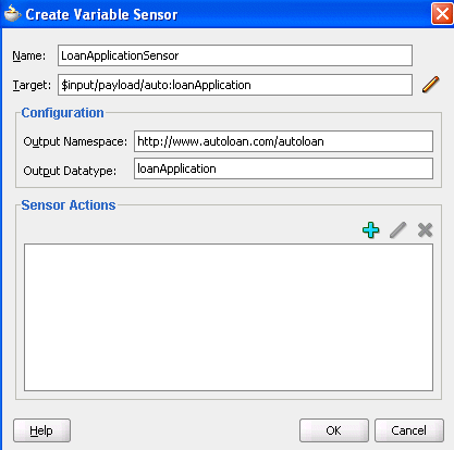

To configure a variable sensor:
If you want to record all the incoming loan requests, you can create a variable sensor.
  1. In the Structure window, expand the Sensors folder.
  2. Right-click Variable, and select Create.
  3. Click the Edit icon to the right of the Target field to create a variable sensor for a variable (for this example, named input), as shown in Figure 17-5.
    Figure 17-5 Creating a Variable Sensor
    Description of Figure 17-5 follows
    Description of "Figure 17-5 Creating a Variable Sensor"
    Based on your selection for the Target field, the Output Namespace and Output Datatype fields are automatically filled in.
    A new entry is created in the bpel_process_name_sensor.xml file, as shown in Example 17-2:
    Example 17-2 bpel_process_name_sensor.xml file
    <sensor sensorName="LoanApplicationSensor"
        classname="oracle.tip.pc.services.reports.dca.agents.BpelVariableSensorAgent"
        kind="variable"
        target="$input/payload">
      <variableConfig outputNamespace="http://www.autoloan.com/ns/autoloan"
                      outputDataType="loanApplication"/>
    </sensor>

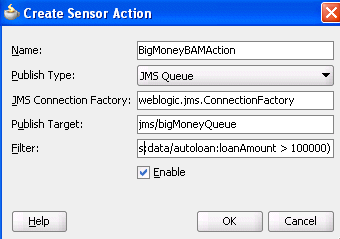

17.2.3 How to Configure Sensor Actions
When you create sensors, you identify the activities, variables, and faults you want to monitor during runtime. If you want to publish the values of the sensors to an endpoint (for example, you want to publish the data of the LoanApplicationSensor variable sensor created in Figure 17-5 to a JMS queue), then create a sensor action, as shown in Figure 17-7, and associate it with the LoanApplicationSensor variable.
To configure a sensor action:
  1. In the Structure window, right-click the Sensor Actions folder.
  2. Select Create > Sensor Action.
  3. Enter the details described in Table 17-1.
    Table 17-1 Sensor Actions Dialog
    Field Description
    Name
    Enter a name or accept the default name.
    Publish Type

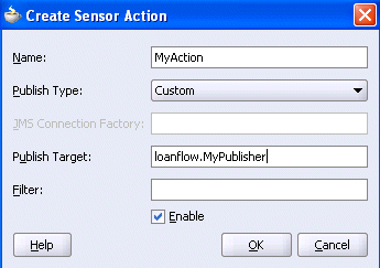

    Select the destination to which to publish sensor data. For more information, see section Section 17.1, "Introduction to Sensors."
    JMS Connection Factory
    If your publish type is JMS Queue, JMS Topic, or JMS Adapter, specify the connection factory.
    Publish Target
    If your publish type is JMS Queue, JMS Topic, Custom, or JMS Adapter, specify the publish target. The publish target represents different things depending on the publish type specified:
    • If the publish type is a database, this field is left blank.
    • If the publish type is JMS Queue, JMS Topic, or JMS Adapter, this represents the JMS destination's JNDI name.
    • If the publish type is Custom, this represents the fully-qualified Java class name.
    Filter
    Enter filter logic as a boolean expression. A filter enables you to monitor sensor data within a specific range. For an example of a configured filter, see Figure 17-9 and Example 17-6.
    Enable
    Deselect this checkbox to disable a sensor action. By default, sensor actions are enabled. If you disable a sensor action by deselecting this checkbox, the action does not publish data.
Figure 17-7 Creating a Sensor Action
Description of Figure 17-7 follows
Description of "Figure 17-7 Creating a Sensor Action"

If you want to monitor loan requests for which the loan amount is greater than $100,000, you can create a sensor action with a filter, as shown in Figure 17-9. There is no design-time validation of the filter query. You must ensure the query is correct.
Figure 17-9 Creating a Sensor Action with a Filter
Description of Figure 17-9 follows
Description of "Figure 17-9 Creating a Sensor Action with a Filter"
A new entry is created in the bpel_process_name_sensorAction.xml file, as shown in Example 17-6:
Example 17-6 bpel_process_name_sensorAction.xml file
<action name="BigMoneyBAMAction"
        enabled='true'
        filter="boolean(/s:actionData/s:payload
                        /s:variableData/s:data
                        /autoloan:loanAmount > 100000)"
        publishType="JMSQueue"
        publishTarget="jms/bigMoneyQueue">
  <sensorName>LoanApplicationSensor</sensorName>
  <property name=“JMSConnectionFactory“>
    weblogic.jms.ConnectionFactory
  </property>
</action>
Notes:
  • You must specify all the namespaces that are required to configure an action filter in the bpel_process_name_sensorAction.xml configuration file. For example, assume you have a customer XML-schema element with namespace "http://myCustomer" and you want to create a filter on the customer age element. Therefore, you must manually declare the namespace for "http:/myCustomer" in the file before you can use it in your filter. Otherwise, it is not possible to create a valid query. Add xmlns:ns1="http://myCustomer" in the attribute declaration part of the file. You can then use ..../ns1:customer/ns1:age/... in your query.
  • You must specify the filter as a boolean XPath expression.
If you have special requirements for a sensor action that cannot be accomplished by using the built-in publish types (database, JMS queue, JMS topic, and JMS Adapter), then you can create a sensor action with the custom publish type, as shown in Figure 17-10. The name in the Publish Target field denotes a fully qualified Java class name that must be implemented. For more information, see Section 17.2.5, "How to Create a Custom Data Publisher."
Figure 17-10 Using the Custom Publish Type
Description of Figure 17-10 follows
Description of "Figure 17-10 Using the Custom Publish Type"
