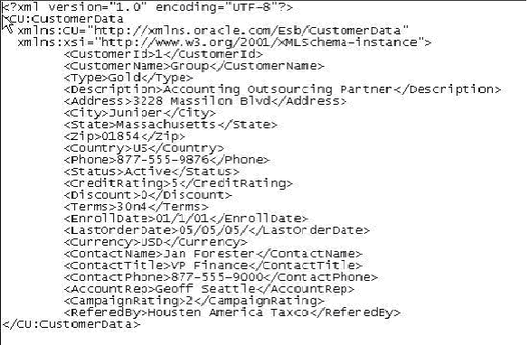

Groups and sequence IDs are identified through XPath expressions in the payload. You specify XPath expressions that point to the elements in the message payload on which grouping is done and on which sequencing is done.
In the message payload shown in Figure 22-1, CustomerId is the field on which to base instance sequencing and CustomerName is the field on which to base grouping.
