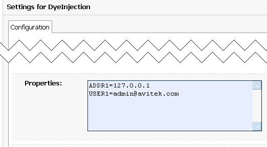

You configure the DyeInjection monitor by assigning values to dyes. The available dye flags are described in Table 12-1.
For example, you could set the flags as follows: USER1=weblogic, USER2=admin@avitek.com, ADDR1=127.0.0.1, ADDR2=127.0.0.2, and so forth. Basically, you want to set the values of one or more flags to the user(s), IP address(es) whose requests you want to monitor.
For example, to monitor all requests initiated by a user named admin@avitek from a client at IP address 127.0.0.1, assign the value admin@avitek to USER1 and assign the value 127.0.0.1 to ADDR1.
In the Administration Console, you assign values to dyes by typing them into the Properties field of the Settings for DyeInjection page. For instructions, see "Configure diagnostic monitors in a diagnostic system module" in the Oracle WebLogic Server Administration Console Help.
Figure 12-1 Setting Dye Values in the Administration Console
These settings appear in the descriptor file for the diagnostic module, as shown in the following code listing.
Example 12-1 Sample DyeInjection Monitor Configuration, in DIAG_MODULE.xml

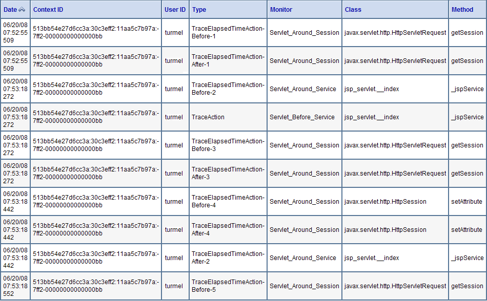

Figure 12-2 shows an example of diagnostic events that were generated when a configured diagnostic action was triggered. Notice that the Context ID is the same for all of the events, indicating that they are related to the same request. You can use this Context ID to query for log records that are associated with the request. Note that the user ID associated with a request may not always be the same as the USER value you configured in the DyeInjection monitor; as a request is processed through the system, the user associated with the request may change to allow the system to perform certain functions (for example, the User ID may change to kernel).
Figure 12-2 Example of Diagnostic Events Associated with a Request

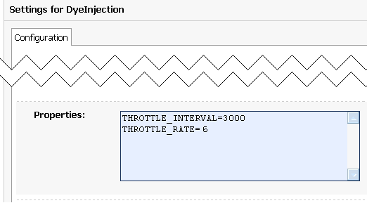

Throttling is used to control the number of requests that are processed by the monitors in a diagnostic module. Throttling is configured using the THROTTLE dye, which is defined in the DyeInjection monitor.
The USERn and ADDRn dyes allow inspection of requests from specific users or IP addresses. However, they do not provide a means to look at arbitrary user transactions. The THROTTLE dye provides that functionality by allowing sampling of requests.Unlike other dyes in the dye vector, the THROTTLE dye is configured through two properties.
THROTTLE_INTERVAL sets an interval (in milliseconds) after which a new incoming request is dyed with the THROTTLE dye.
If the THROTTLE_INTERVAL is greater than 0, the DyeInjection monitor sets the THROTTLE dye flag in the dye vector of an incoming request if the last request dyed with THROTTLE arrived at least THROTTLE_INTERVAL before the new request. For example, if THROTTLE_INTERVAL=3000, the DyeInjection monitor waits at least 3000 milliseconds before it will dye an incoming request with THROTTLE.
THROTTLE_RATE sets the rate (in terms of the number of incoming requests) by which new incoming requests are dyed with the THROTTLE dye.
If THROTTLE_RATE is greater than 0, the DyeInjection monitor sets the THROTTLE dye flag in the dye vector of an incoming request when the number of requests since the last request dyed with THROTTLE equals THROTTLE_RATE. For example, if THROTTLE_RATE = 6, every sixth request is dyed with THROTTLE.
You can use THROTTLE_INTERVAL and THROTTLE_RATE together. If either condition is satisfied, the request is dyed with the THROTTLE dye.
If you assign a value to either THROTTLE_INTERVAL or THROTTLE_RATE (or both, or neither), you are configuring the THROTTLE dye. A THROTTLE configuration setting in the Administration Console is shown in the following figure.
Example 12-3 shows the resulting configuration in the descriptor file for the diagnostics module.
Example 12-3 Sample THROTTLE Configuration in the DyeInjection Monitor, in DIAG_MODULE.xml
