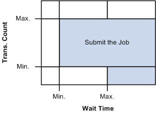

The shaded area labeled Submit the Job in the following chart graphically shows the conditions under which the application processes are automatically submitted by the system for processing.
Conditions for submitting a job
The process first looks at the minimum (Min.) specified Wait Time and if it is met or exceeded, the process then looks at the Transaction Count (Trans. Count).
If the journal line transaction count meets or exceeds the minimum, the application batch process is initiated unless the maximum (Max.) transaction count is exceeded.
Attaining the maximum Wait Time initiates the process unless the transaction count maximum is exceeded.
Maximum Transaction Count provides a ceiling to prevent jobs that are too big to be processed at certain times from being processed using the Autopilot.
When the transaction count exceeds the maximum, user intervention is necessary to make the application process recur again. You can manually process the journals or alter the journal to reduce the count so that it is under the maximum transaction count, or increase the maximum transaction count if practical.
