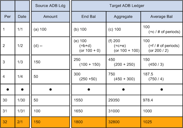

The following two tables illustrate incremental calculation by showing how February 1 is calculated using two different time periods (period types): year to date and month to date.
This table shows how the system calculates February 1 for a YTD (year to date) period.
Incremental Calculation for YTD
The following table shows how the system performs incremental year to date calculations:
Year to date example: February 1 is the 32nd day of the period

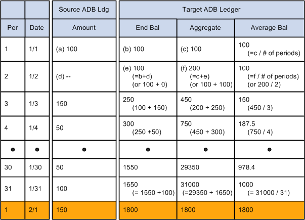

Incremental Calculation for MTD
ADB for the month-to-date (MTD) should not include the ending balance for the prior period as the beginning balance for the current period. MTD is for the month only and the calculation does not include any amounts from any other period.
The following table shows how the system calculates February 1 for a MTD (month to date) period:
Month to date example: February 1 is the first day of the second period
