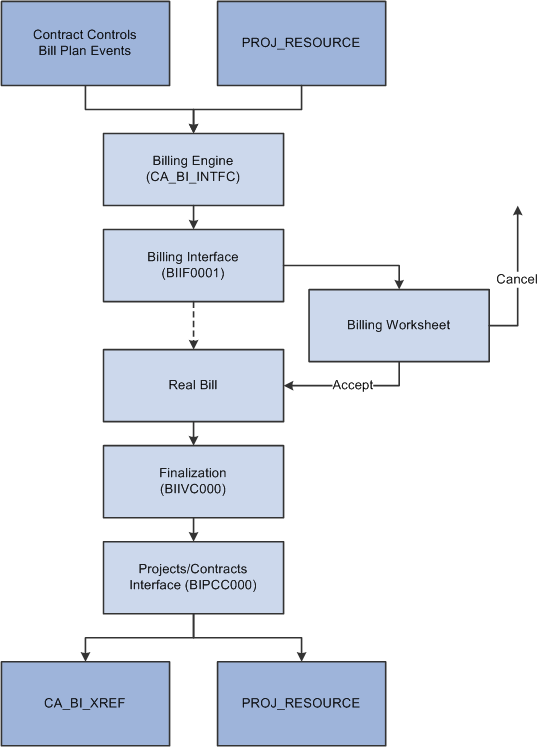

Process Overview
For rate-based billing in PeopleSoft Grants, the Contracts/Billing Interface process (CA_BI_INTFC) selects resource rows from PeopleSoft Project Costing. The system also selects contract lines in PeopleSoft Contracts with Ready bill plans to create bill lines in the billing interface (INTFC_BI and its related tables). When the Contracts/Billing Interface process stages billing data in these tables, the billing interface processes the data to create bills.
The billing interface can create two types of bills:
Temporary bills
These bills are routed to the billing worksheet, where the billing administrator can review and, for rate-based bills, amend them as needed before real bills are created. You cannot amend fixed-amount bills in the billing worksheet.
Real bills
These bills become invoices that are sent to the customer. You select the option to create temporary or real bills for individual billing plans on the Billing Plan - Billing Plan General page in PeopleSoft Contracts.
You can use the billing worksheet to cancel temporary bills. When you cancel a temporary bill from within the billing worksheet, the system updates PeopleSoft Project Costing and PeopleSoft Contracts accordingly.
After you review a temporary bill on the billing worksheet, you can create a real bill. The system creates a real bill after a user approves it and saves the worksheet. When the bill is finalized, the system updates the Project Resource table (PROJ_RESOURCE) and the Contracts/Billing Interface Xref table (CA_BP_XREF).
This flow chart illustrates the billing process flow for Grants transactions. Billable transactions stored in Contracts and the PROJ_RESOURCE table is selected by the CA_BI_INTFC process and passed to Billing through the Billing Interface process. After the bills are finalized, the Projects/Contracts Interface process updates Contracts and Project Costing with the billed award transaction data:

Customer Contracts, Schedule and Process Billing Then select either Process As Incurred Billing, Process Recurring Billing, or Process Other Billing Methods. |
Run the Billing Interface process (BIIF0001) in PeopleSoft Billing. |
Billing, Interface Transactions, Process Billing Interface |
Approve the bill lines for the billing worksheet and create a real bill. |
Billing, Manage Billing Worksheet, Update Billing Worksheet |
Finalize the prepaid initial billing by running the Billing Finalization Process (BIIVC000). |
Billing, Generate Invoices, Non-Consolidated, Finalize and Print Invoices OR Billing, Generate Invoices, Consolidated, Finalize and Print Invoices |
Update the Contracts Prepaid tables with the advance billing information by running the Billing to Projects/Contracts Interface process (BIPCC000) in PeopleSoft Billing. |
Billing, Generate Invoices, Utilities, Update Contract/Projects Data |
Run the Billing-to-Projects process (PC_BI_TO_PC) to update the PeopleSoft Project Costing tables with the billed and utilization information. |
Project Costing, Revenue Collection, Retrieve Billing Items |
