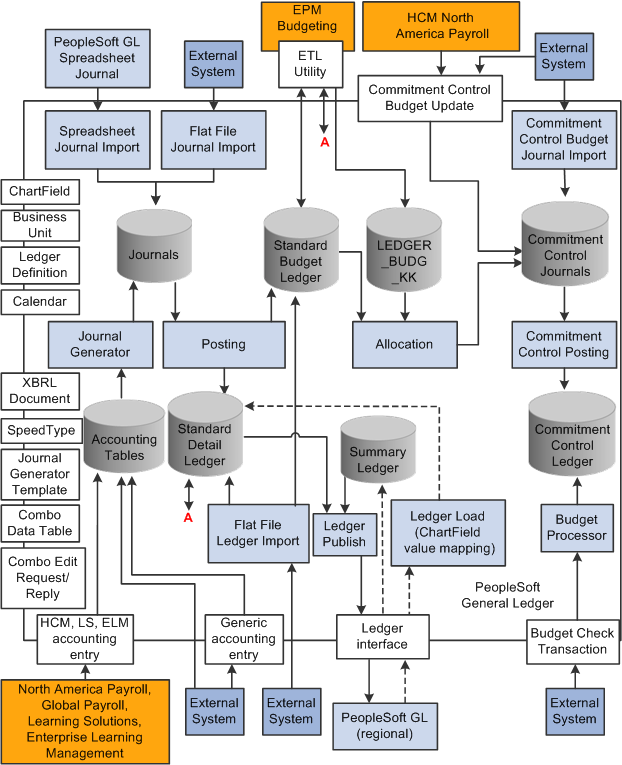

This chapter discusses the:
Integration diagram of commitment control with PeopleSoft and third-party applications.
Integration of commitment control with PeopleSoft applications.
Integration of commitment control with third-party applications.
Integration Diagram of Commitment Control With PeopleSoft and Third-Party
ApplicationsThe following diagram shows the major integrations for Oracle's PeopleSoft Enterprise applications and third-party applications with commitment control as well as related general ledger integrations:
PeopleSoft and third party integration with Commitment Control
Integration of Commitment Control with PeopleSoft Applications
Oracle's PeopleSoft Enterprise Commitment Control enables you to create budgets and budget check source transactions originating in various PeopleSoft applications.
Commitment Control integrates with the following PeopleSoft Enterprise subsystem applications:

Understanding Commitment Control Integration with PeopleSoft and Third-Party Applications
Integration of Commitment Control with Third-Party Applications
This section discusses loading budgets from third-party applications.
Commitment Control enables you to receive budget entries and budget checks source transactions from third-party applications.
Loading Budgets from Third-Party Applications
If you formulate budgets in a third-party application, you can interface the budget information to General Ledger and maintain the budget information directly in the Commitment Control ledger. You must first set up Commitment Control ledger groups and budget definitions for the budget journals.
There are two methods to import budgets to Commitment Control from third-party applications:
Use the Commitment Control Budget Update Enterprise Integration Point (IP) to receive Commitment Control journals and update budgets.
Use the Commitment Control Budget Journal Flat File Import process to import budget data directly from flat files.
Using the Commitment Control Budget Update IP
To use this IP, you must activate the COMMIT_CNTRL_BUDGET_UPDATE application message and it's related integration objects. Please see General Ledger "Integrating and Transferring Information Among Applications" for more details.
The IP receives Commitment Control journals into the PS_KK_BUDGET_HDR and PS_KK_BUDGET_LN tables and automatically runs the Commitment Control Posting process (FS_BP).

Commitment Control enables you to receive source transactions from a third-party application and to budget check them and update the control budget amount for the transactions using the Budget Processor. You use the Budget Check Transaction IP to subscribe to transaction data received from third-party application and to publish the results back to the originating application.
The Budget Check Transaction IP updates the PS_COMCNTL_TRN_HDR and PS_COMCNTL_TRN_LN tables with the transaction data. It also updates the KK_GEN_TRN_AET table and then uses this information to run the Budget Processor automatically. The Budget Processor checks these transactions as it would any other source transactions and does the following:
Updates the budget amount for valid transactions, including transactions with warning exceptions.
Generates error exceptions for transactions that fail budget checking.
The IP then publishes a message back to the third-party application to indicate whether the transaction failed or passed budget checking. The third-party application can use the information in the message to restrict or allow further processing of the transaction.
