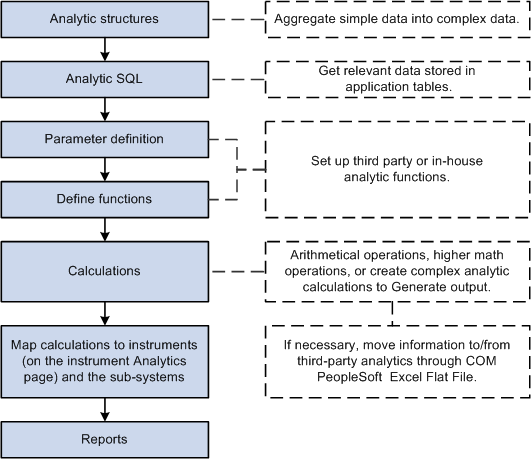

Understanding Analytic Parameters, Analytic Structures, and Interface
MethodsThis flowchart illustrates the setup process for enterprise risk management:
Setting up enterprise risk management
The first step to running analytics is establishing the analytic structures' definitions.
By the time you are ready to perform this step, you may have chosen your analytic solution vendor and gone through vendor-specific functional data requirements. Most analytic functions use structured parameters as inputs.
Analytic Parameters
Analytic parameters can range from generic yield curves with a maturity date and corresponding rate as component fields to complex cash flow sets and vendor-specific structures that have more than three fields as components. For example, a yield curve parameter that is being passed to a function could look like this:

Analytic Structures
To enable the use of such a parameter, we define it as a structure. Structures enable the definition of complex parameters required by the analytic solution functions in a specific format. PeopleSoft tables store the application and market data as normal fields and not as structures. This step enables you to combine the simple data types stored in the PeopleSoft rate tables and to build the complex data structures required by the analytic vendor that you specify.
In a later step, you can use SQL statements to retrieve complex data parameters from the application tables and incorporate these parameters into their respective functions.
