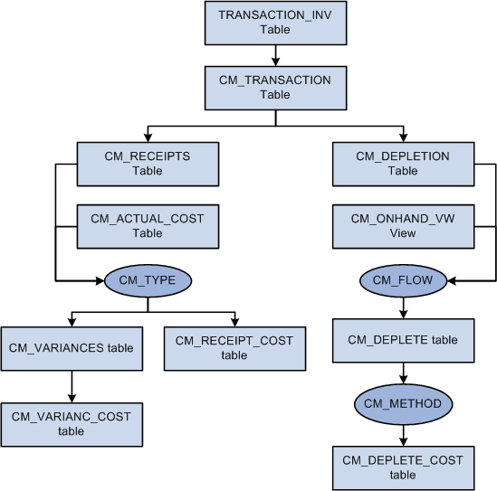

This diagram illustrates the cost flow for a lot controlled item:
Lot-Control Costing Example

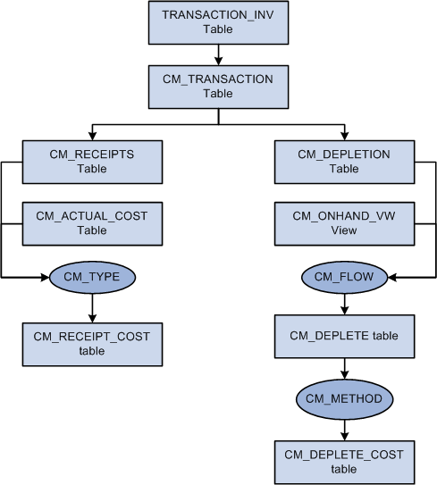

This diagram illustrates the cost flow for a FIFO or LIFO item:
FIFO and LIFO Costing Example

This example details the perpetual and periodic average cost methods that are used in PeopleSoft Cost Management. For this example, this information is used:
Inventory Business Unit |
US011 |
US011 |
Item ID |
A |
A |
Cost Book |
FIN |
TAX |
From Cost Profile |
Receipt Cost Method (CM_TYPE) |
Actual |
Actual |
Cost Flow (CM_FLOW) |
FIFO |
FIFO |
Deplete Cost Method (CM_METHOD) |
Perpetual Average |
Periodic Average |
Cost Element Option |
Production |
N/A |
For the TAX cost book, assume that the average is calculated only once, at the end of the period (periodic).
For the FIN cost book, assume that the average is calculated after each putaway.

This diagram illustrates the cost flow for a perpetual and periodic average cost item:
Perpetual and Periodic Average Costing Example
The TRANSACTION_INV Table

Costing Standard Cost Items
This diagram details the standard cost method used in PeopleSoft Cost Management. For this example, this information is used:
US009 |
US009 |
Item ID |
A |
A |
Cost Book |
FIN |
TAX |
From Cost Profile |
Standard |
Actual |
FIFO |
LIFO |
Standard |
Actual |
Standard costs used for item A:
US009 |
US009 |
Item ID |
A |
A |
Cost Element |
100 |
200 |
Unit Cost |
18.00 |
3.00 |
This diagram illustrates the cost flow for a standard cost item:
Standard Costing Example

The CM_DEPLETE_COST Table
The process calculates the cost of depletions in the CM_DEPLETE table and placed them in the CM_DEPLETE_COST table. This is based on the Deplete Cost Method defined on the Cost Profiles page.

Example: Determining Your Cost Structure Strategy
These examples illustrate the different strategies for setting up the books and profiles, along with the steps that are necessary for each option. When deciding on an approach, be sure to consider future as well as current accounting and management requirements. The scenarios for cost structure strategies include:
Using one cost profile and one book.
Using different cost profiles in a business unit.
Using different cost profiles in different business units.
Using multiple simultaneous costing methods in one business unit.
Using One Cost Profile and One Book
This method is employed for environments where all items use the same cost method. Additionally, if the financial reporting requirements are simple, you can utilize the single book/single profile setup. For example, if all the items use the same costing method for all business units and you want to use one cost book, the steps to set up PeopleSoft Cost Management are simple and straightforward:
Define a single cost book.
Define a single cost profile.
Define a single standard cost group and assign the book and cost profile to that cost group.
As items are created at the setID level, assign them the standard cost group.
Define the PeopleSoft Inventory business units, and point to a corresponding PeopleSoft General Ledger business unit. Add the book to the PeopleSoft Inventory business units and point it to the primary ledgers that are in the default ledger groups for the PeopleSoft General Ledger business unit. If you manufacture items by using actual or average costing, also enter a cost type on the inventory business unit.
Now you are ready to add items to the PeopleSoft Inventory business unit. As you add items, the cost profile appears as the default value. No further set up is necessary.
