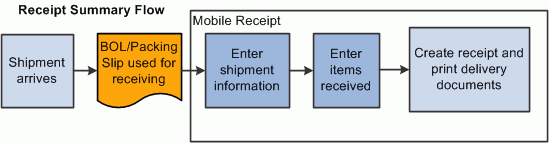

When stock arrives at the receiving location, you receive it using a mobile device with the Mobile Receiving task flow. You can receive inventory or non-inventory items, with or without associated purchase orders. Receipts with a purchase order can be for items that will be stocked in inventory or for items that will go directly to par locations or go directly to various departments. A receipt without a purchase order (ad hoc receipt) can be interfaced to the same products as a purchase order receipt. Only non-inventory items can be received without a purchase order.
The next diagram illustrates the flow of information through the Mobile Receiving process beginning with when the shipment arrives at the ship to location:
Process flow for Mobile Receiving
When a shipment arrives at the receiving location, it typically arrives with a bill of lading or packing slip. These documents can be used to gather information needed to record the receipt. Using a mobile device at the receiving location, you can input shipment information. You select items to be received. After selecting the items, you can create the receipt. The information is relayed back to the PeopleSoft system where you can perform the downstream receipt processes.
Note. Entering shipment information is optional.
You can also select to print delivery documents. Delivery information becomes available only after the item has been received. When you select to print delivery documents, the system uses the receipt information and initiates the RECV_DEL multi-process job. The job gathers receiving data for the Receipt Delivery Detail report.
