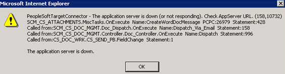

– The application sever URL on the installation page is not setup correctly, but the gateway is. The message appears as follows:
Message example
To resolve the message, update the URL entry on the Installation Options page to be //<app server machine>:<JSL Port>.

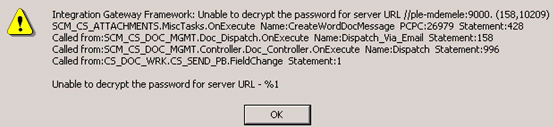

– If you did not enter a default value or user ID and password on the configuration setting for the gateway properties, this message appears:
Message example

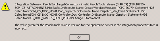

– The integration gateway is on version XX while the application server defined on the Installation Options page is on YY.
Message example
To verify the server PeopleSoft PeopleTools version:
Select: PeopleTools, Integration Broker, Configuration, Gateways.
The Gateways page appears.
Click the Ping Gateway button.
The PeopleSoft Integration Gateway page appears with the PeopleTools version. Make note of the version.
Open the Gateways page again.
Click the Gateway Setup Properties link.
The Configuration page appears.
Make sure that the PeopleTools release version listed in the top portion of the page and in the grid is the same as the one that appeared when you clicked the Ping Gateway button.
Verify that the Microsoft Windows application server defined in the Compare/Render Server/Path field on the Installation Options page is the same one as defined for the version of PeopleTools.
