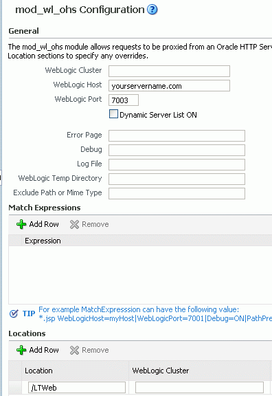

This section demonstrates the configuration of mod_wl_ohs using EM. However, it is also possible to do the same configuration by manually editing the configuration files.
To configure mod_wl_ohs from EM, perform the following:
Select the OHS instance on the left panel.
Select Oracle HTTP Server > Administration > mod_wl_ohs Configuration on the right panel.
Enter the value for WebLogic Host, WebLogic Port, and Locations. Figure 10-2 shows a sample setup for Learning Tool Admin and Learning Tool.
This configuration will effectively be added to the mod_wl_ohs.conf file of this OHS instance. You can also manually modify this file without using the EM.

Perform similar steps as Section 10.2.4, "Configuring mod_osso to Protect Web Resources" to configure mod_wl_ohs.
LoadModule osso_module "${ORACLE_HOME}/ohs/modules/mod_osso.so"
<IfModule osso_module>
OssoIpCheck on
OssoIdleTimeout off
OssoSecureCookies off
OssoConfigFile ${ORACLE_INSTANCE}/config/${COMPONENT_TYPE}/${COMPONENT_
NAME}/osso/osso_ucm.conf
<Location /cs>
require valid-user
AuthType Osso
</Location>
</IfModule>
