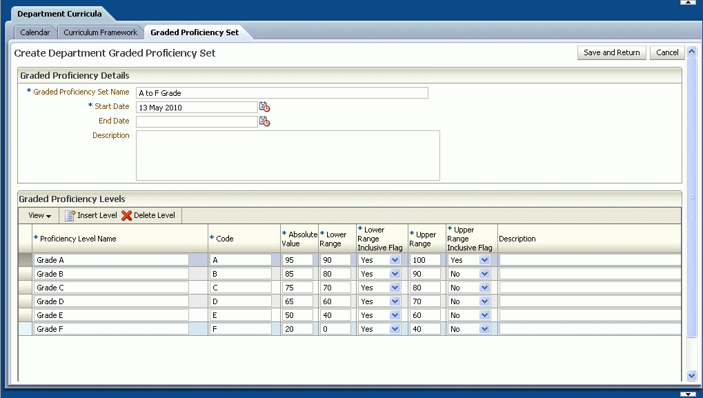

A Graded Proficiency Set is a grade-based assessment framework defined by the Department that is made available to Schools for their assessment.
This section includes the following topics:
To create a graded proficiency set, perform the following:
On the Department Curricula tab, click the Graded Proficiency Set subtab.
The Search Department Graded Proficiency Set page displays. Click Create.
The Create Department Graded Proficiency Set displays, which enables you to enter the following:
Graded Proficiency Set Name
The name of the new department graded proficiency set.
Start Date
The start date of the department graded proficiency set.
End Date
The end date of the department graded proficiency set.
Description
A description of the department graded proficiency set.
Create proficiency levels within the graded proficiency set.
You must fully define the total range of all graded proficiency levels in the graded proficiency set, which cover a scale from 0 to 100, before the set can be saved.On the Graded Proficiency Levels table of the Create Department Graded Proficiency Set page, click Insert Level.
A new row with fields in editable mode appears, which enables you to enter the following:
Proficiency Level Name
Enter the name of the department graded proficiency level.
Code
A code that is used to indicate the department graded proficiency level.
Absolute Value
A numeric value that is used to rank or convert the department graded proficiency level.
The absolute value must be higher than or equal to the lower range value and lower than or equal to the upper range value.
A proficiency level with a higher absolute value appears toward the end of a list of values.
Lower Range
The lower boundary of the proficiency level range that you can convert from a mark to a proficiency level.
A numeric value from scale of 0 to 100.
Lower Range Inclusive Flag
Indicates whether the range value is inclusive of the Lower Range.
Upper Range
The upper boundary of the proficiency level range that you can convert from a mark to a proficiency level.
Upper Range Inclusive Flag
Indicates whether the range value is inclusive of the Upper Range.
Description
A description of the department graded proficiency level.
Click Save and Return.

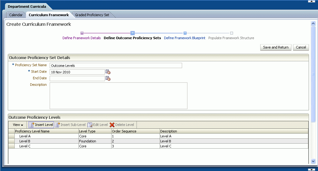

This section describes how to manage the Department curriculum framework. It includes the following topics:

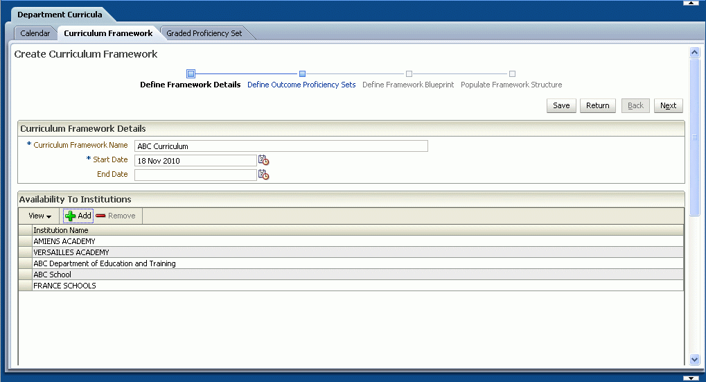

To create a curriculum framework, perform the following:
On the Department Curricula tab, click the Curriculum Framework subtab.
The Search Curriculum Framework page displays. Click Create.
The Create Curriculum Framework page displays. In this page, a guided process displays the first process Define Framework Details.
Enter the following curriculum framework details:
Curriculum Framework Name
The name of the department curriculum framework.
Start Date
The start date of the department curriculum framework.
The start date should be later than end date.
End Date
The end date of the department curriculum framework.
You can make the curriculum framework available to other institutions or institution groups. To perform these tasks, see Add an Institution and Add an Institution Group.
Click Next. The Define Outcome Proficiency Sets process is displayed.
To define the outcome proficiency set, see Manage Outcome Proficiency Sets.
The newly created outcome proficiency set is added to the curriculum framework.

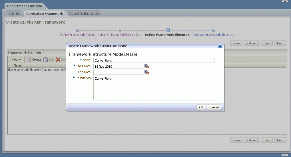

Click Next. The Define Framework Blueprint process is displayed.
To define the framework blueprint and framework types that form the framework structure, see Manage a Curriculum Framework Blueprint.
After you define the entire framework blueprint, click Next. The Populate Framework Structure process is displayed.

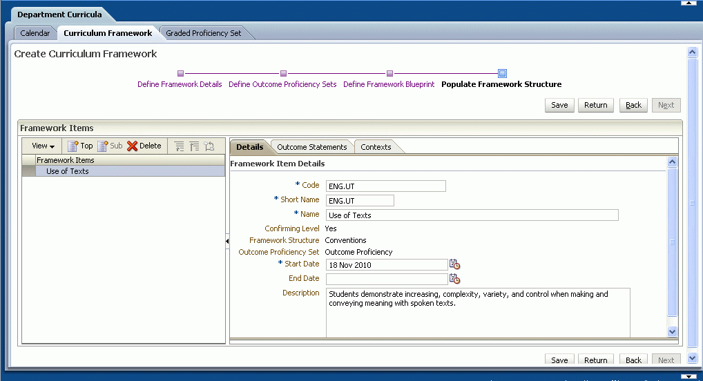

An empty tree table appears that shows the initial framework structure without any framework items populated into it.
On the left section of the Framework Items tree table, click Top to add a top level framework item.
To define the framework items, see Manage Framework Items.
The new framework item is added as a top level item.
To add a child into the existing framework item, see Manage Framework Items.
Child framework items are added into the existing framework item.
Select the desired framework item on the Framework Items tree table.
On the right section of the Framework Items tree table, click the Context tab. Click Create Department Context.

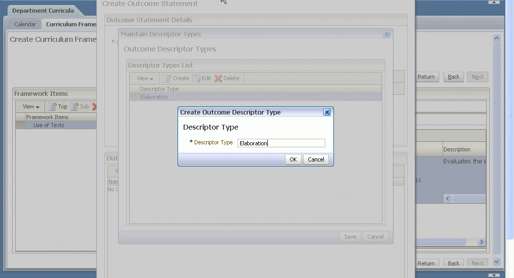

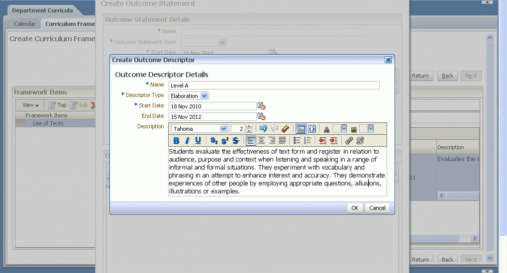

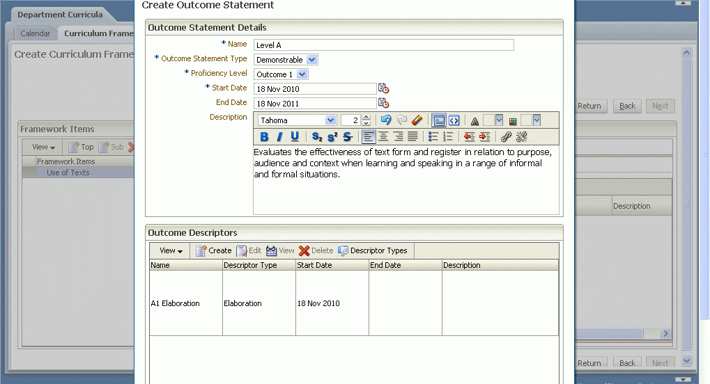

On the right section of the Framework Items tree table, click the Outcome Statements tab.
To create an outcome statement, see Manage Outcome Statements.

On the Availability to Institutions table of the Create Curriculum Framework page, click Add.
The Search Institution dialog appears, which enables you to search for the institution and select the institution.
Click OK.

You can select to edit each process of the selected curriculum framework.
On the guided process, select a process to edit the details:

To create an outcome proficiency set, perform the following:
Perform Steps 1 to 4 in Create a Curriculum Framework.
In the Create Curriculum Framework page, select the next process Define Outcome Proficiency Sets in the guided process.
Click Create.
In the Outcome Proficiency Set Details table, enter the following details for the new outcome proficiency set:
The name of the new outcome proficiency set.
Start Date
The start date of the outcome proficiency set.
End Date
The end date of the outcome proficiency set.
Description
A description of the outcome proficiency set.
In the Outcome Proficiency Levels table, click Insert Level to add a new outcome proficiency level and add it to the outcome proficiency set.
The Insert Level dialog appears, which enables you to enter the following details:
The name of the outcome proficiency set level.
Level Type
Select the type of outcome proficiency level from the options:
Core
Foundation
Order Sequence
A numeric value that is used to indicate the ranking of the outcome proficiency level.
For example:
Poor can be set in an order sequence number 1
Average can be set in an order sequence number 2
Good can be set in an order sequence number 3
Description
If you want to add an outcome proficiency sub-level as a child of the selected outcome proficiency level, click Insert Sub-level.
The Insert Sub-Level dialog appears, which enables you to enter the following details for the new outcome proficiency sub-level:
The name of the outcome proficiency set sub-level.
Type
Select the type of the outcome proficiency set sub-level options:
Core
Foundation
Order Sequence Number
Description
A description of the outcome proficiency set sub-level.
The new outcome proficiency set is created in the system.

To create a curriculum framework blueprint, perform the following:
Perform Steps 1 to 7 in Create a Curriculum Framework.
In the Create Curriculum Framework page, select the Define Framework Blueprint process.
In the Framework Blueprint table, click Create. The Create Framework Structure Node dialog appears, which enables you to enter the following details:
Name
The name of the framework blueprint node.
Start Date
The start date of the framework blueprint node.
End Date
The end date of the framework blueprint node.
Description
A description of the framework blueprint node.
Click OK.
Click Save.

A curriculum framework consists of a structured hierarchy of framework items.
This section describes how to manage framework items. It includes the following topics:
To create a curriculum framework item, perform the following:
Perform Steps 1 to 11 in Create a Curriculum Framework.
On the left section of the Framework Items table, click Top.
The Create Top Framework Item dialog appears, which enables you to enter the following:
Code
A code for the new curriculum framework item.
Short Name
A short name for the new curriculum framework item.
Name
The full name of the new curriculum framework item.
Confirming Level
Indicates whether confirmations can be made against the new curriculum framework item.
Select from the options:
Yes
No
Framework Structure
Select the framework blueprint node from the options.
Select the outcome proficiency set from the options.
Start Date
The start date of the curriculum framework item.
End Date
The end date of the curriculum framework item.
Description
A description of the curriculum framework item.
Click OK.
You can also create a child framework item under an existing top level framework item.
To create a child framework item, perform the following:
On the left section of the Framework Item table, select the top level framework item to add on the child type framework item.
Click Sub. The Create Sub Framework Item dialog appears, which enables you to enter the following:
Code
A code that is used for the new curriculum framework item.
Short Name
Name
The name of the new curriculum framework item.
Confirming Level
Indicates whether confirmations can be made against the new curriculum framework item. Select from the options::
Yes
No
Framework Structure
Start Date
End Date
Description
Click OK.
Click Save.

To create an outcome statement, perform the following:
Perform Steps 1 to 18 in Create a Curriculum Framework.
In the Outcome Statements table, click Create.
The Create Outcome Statement dialog appears, which enables you to enter the following:
Name
The name of the outcome statement.
Outcome Statement Type
Select one of the outcome statement type options:
Annotative
An annotative outcome statement is useful for providing annotations within the curriculum, but cannot be used for making assessments against the curriculum.
Demonstrable
A demonstrable outcome statement is the normal type of outcome statement that can be used for making assessments against the curriculum.
Indicative
An indicative outcome statement is useful for indicating student expectations within the curriculum, but cannot be used for making assessments against the curriculum.
Start Date
The start date of the outcome statement.
End Date
The end date of the outcome statement.
Description
The details of the outcome statement using HTML or plain text.
Click OK.
Click Save.

An Outcome Descriptor Type indicates the type of the outcome descriptor.
This section describes how to manage the outcome descriptor types. It includes the following topics:
To create an outcome descriptor type, perform the following:
Perform Steps 2 to 3 in Create an Outcome Statement.
In the Outcome Descriptors table, click Descriptor Types.
The Maintain Descriptor Types appears.
Click Create. The Create Outcome Descriptor Type appears, which enables you to enter the name of the descriptor type in the Descriptor Type field.
Click OK.
The new descriptor type appears in the list of available descriptor types.

Click Edit. The Edit Outcome Descriptor Type dialog appears, which enables you to edit the name of the descriptor type.
Click OK.
To delete an outcome descriptor type, perform the following:
Perform Steps 1 to 2 in Edit an Outcome Descriptor.
Click Descriptor Type. The Maintain Descriptor Type dialog appears.
Click Delete. A confirmation dialog appears to confirm the deletion.
Click OK.
You can provide additional information surrounding an outcome statement in the outcome descriptors.
This section describes how to manage an outcome descriptor. It includes the following topics:
You must define a Descriptor Type before you can create an Outcome Descriptor. For more information on how to create a descriptor type, see Create an Outcome Descriptor Type.To create an outcome descriptor, perform the following:
On the Outcome Descriptors table of the Create Outcome Statement dialog, click Create.
The Create Outcome Descriptor dialog appears, which enables you to enter the following:
Name
The name of the outcome descriptor.
Descriptor Type
Select from the descriptor type options.
Start Date
The start date of the outcome descriptor.
End Date
The end date of the outcome descriptor.
Description
A description of the outcome descriptor in plain text.
Click OK.
To view the details of an outcome descriptor, perform the following:
Perform Steps 1 to 3 in View an Outcome Statement.
The View Outcome Statement dialog displays a list of all the outcome descriptors defined for the outcome statement.
On the Outcome Descriptors table, select the outcome descriptor to view.
Click View. The View Outcome Descriptor dialog appears, which shows the details of the outcome descriptor.
