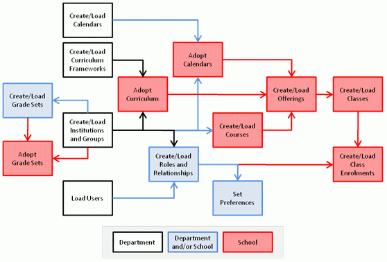

Regardless of the extent to which automated processes are used, the sequence of the tasks must be properly thought out and planned. In Figure 7-1, all of the functional setup and maintenance tasks are laid out in a flowchart to indicate the interdependencies between them.
The instructions on how to perform each of the setup tasks using the LTAdmin are described in the Oracle Student Learning Learning Tool Admin User's Guide Release.

The sequence in which these objects are created or loaded is of no consequence. The objects may even be created after loading the schools and people. However, these objects must be created so they can be "adopted" by schools (and it is usually simpler to adopt calendars, curricula, and grade sets at the instantiation of the school).

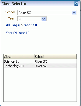

Tags should be applied to courses so that the classes (which ultimately hang off the courses) can be navigated in the LT, as illustrated in Figure 7-2.

The previous section outlines the sequence through which the functional setup tasks need to occur to ready an OSL environment for use by students, teacher, and parents. The following table summarizes all of these tasks including their dependencies and expected frequencies.
| Data Object | Dependencies | Frequency | Comment | Method |
