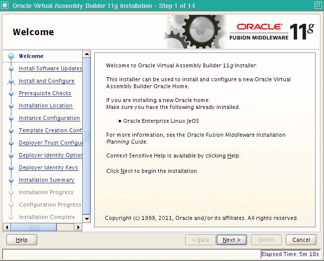

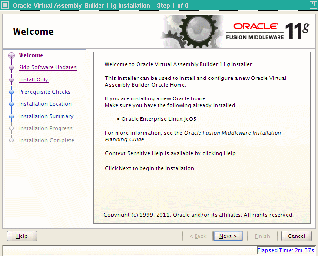

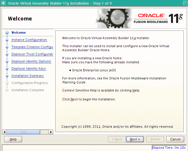

Welcome. This page introduces the installation. The flow of installation appears in the left panel, and control buttons appear along the bottom.

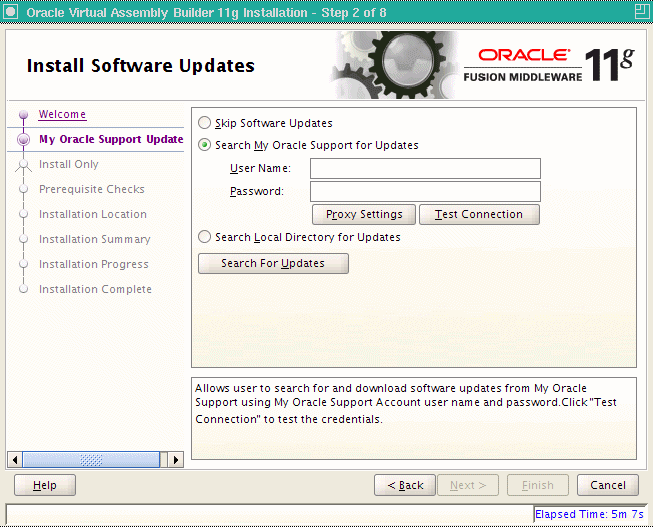

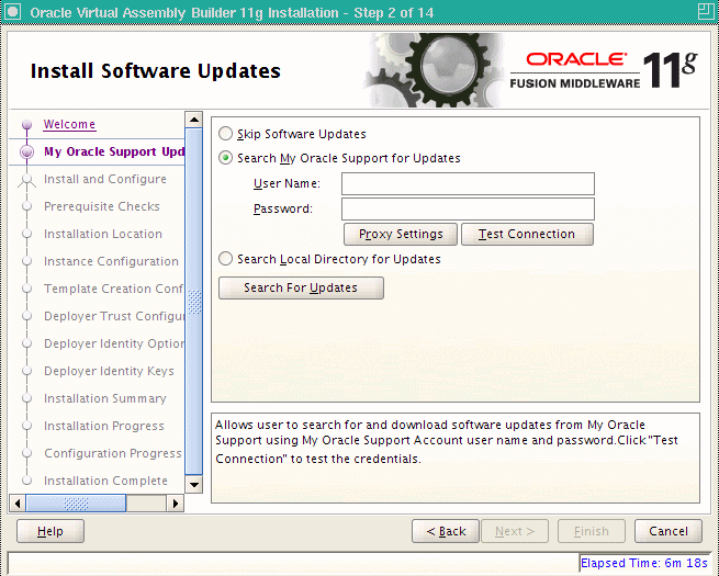

When you are ready to begin installation, click Next. The Install Software Updates page appears.
Help is available on all of the pages. Use it to learn about what you can do in that page, field descriptions, possible values, and other information.Software Updates. Before continuing with installation, you should ensure that your Oracle software is up to date. You have the option to skip this step by selecting the Skip Software Updates radio button, but only skip updates if you are sure that all of your software is up to date.
Enter your Oracle Support user name and password, then click Test Connection to test your credentials.

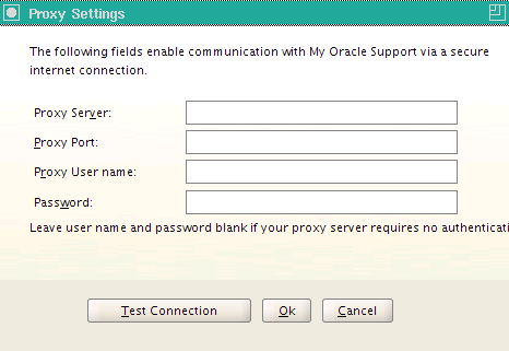

Click Proxy Settings (optional) if your computer is behind a firewall or a proxy and not in direct contact with the Internet.
Enter proxy information and test the connection and/or click OK.
Click Skip Software Updates if you do not want to search for any software updates.
Click Next. Updates are installed, and the Select Installation Type page appears.

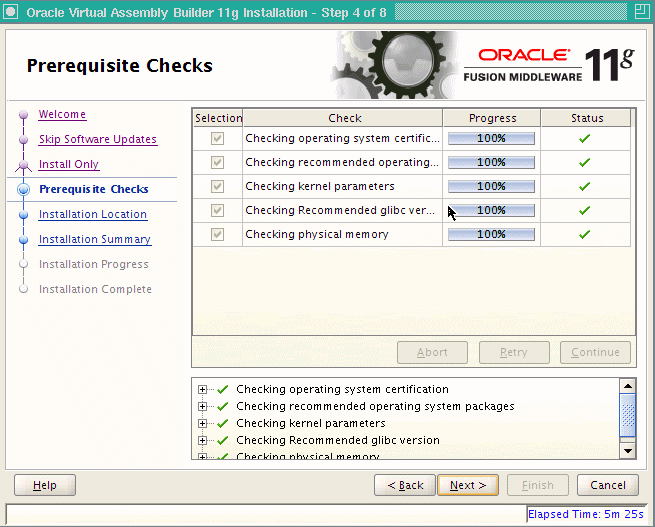

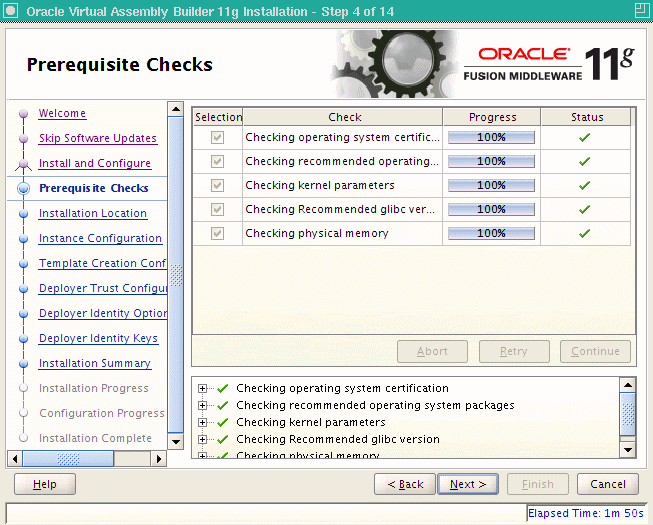

Prerequisites Checks. Checks begin automatically. Progress notes inform you about what is being checked, and what the outcome of the check is. You can abort, retry, or continue checks using the buttons on the page. For example, if a physical memory check fails, you can go and correct the problem, then click Retry to direct Oracle Universal Installer to recheck the item.
Click Next when the prerequisite checks are complete. The Specify Installation Location page appears.

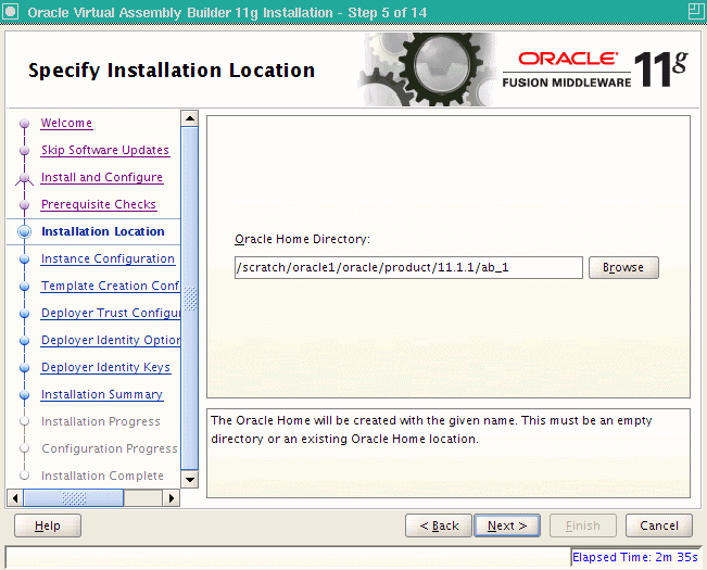

Figure 2-6 Specify Installation Location page
Specify Installation Location. You can select an existing Oracle Home location, or you can specify a new one. If you want to use a new directory, ensure that the directory is empty.
Existing Oracle Homes:Installing into an existing Oracle Home is limited; that is, users can install only into the same type of Oracle Home (in this case, an OVAB Oracle Home). You cannot install into another type of Oracle Home (such as an Oracle Home for SOA).
Installing into an existing Oracle Home is typically done to reinstall binaries, and in some cases, to upgrade an Oracle Home from one release to another.
Oracle Universal Installer checks non-empty Oracle Homes to verify that the selected Oracle Home is valid.

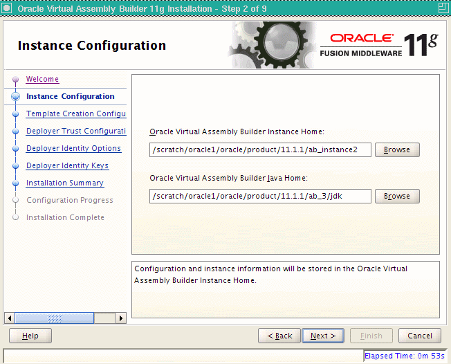

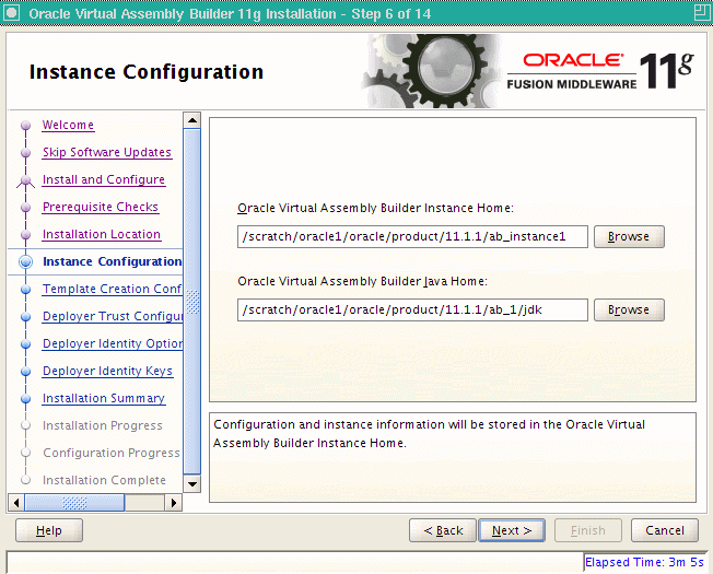

Instance Configuration. Enter, or choose, the Oracle Virtual Assembly Builder Instance Home, and the Oracle Virtual Assembly Builder Java Home.
Oracle Virtual Assembly Builder Instance Home: The home of an Oracle Virtual Assembly Builder instance.
Oracle Virtual Assembly Builder Java Home: The Java Home for Oracle Virtual Assembly Builder.
If you start installation without an explicit JRE location, the JAVA_HOME location will default to $ORACLE_HOME/jdk (the location where JDK will be installed). You can change to another JDK location, in which case the JDK will NOT be installed.Click Next. The Template Creation Configuration page appears.

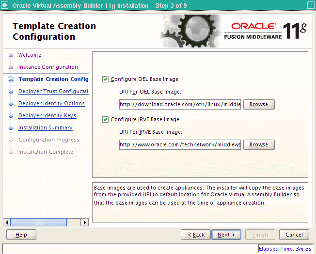

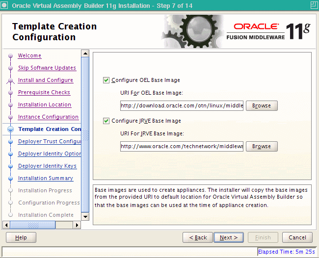

Figure 2-8 Template Creation Configuration page
Template Creation Configuration. This page enables you to define base images that you will use to create new appliances. On this page, you provide the URIs for the OEL and JRVE Base Images.
When you choose to configure OEL and JRVE base images, Oracle Installer copies a user-provided OEL base image in $AB_INSTANCE/templates/baseImage/OVM/OEL and JRVE base image in the $AB_INSTANCE/templates/baseImage/OVM/JRVE directory. These base images will be available as the default base images for this OVAB instance.If you want to have base images shared across all Oracle Virtual Assembly Builder instances, do not select to configure OEL and JRVE base images here and do this after install completes:
Create following directories inside $ORACLE_HOME directory:
$ORACLE_HOME/templates/baseImage/OVM/OEL
$ORACLE_HOME/templates/baseImage/OVM/JRVE
Copy OEL base image files (System.img and vm.cfg) into $ORACLE_HOME/templates/baseImag/OVM/OEL directory
Copy JRVE base image files (system.img and vm.cfg) into $ORACLE_HOME/templates/baseImage/OVM/JRVE directory
Base images are stored in either $AB_INSTANCE, or in $ORACLE_HOME. Here is the order of precedence for base image detection:location specified by -baseImage flag
$AB_INSTANCE/templates/baseImage/OVM/[JRVE|OEL]
$ORACLE_HOME/templates/baseImage/OVM/[JRVE|OEL]
Configure OEL Base Image: If selected, provide the URI for OEL Base Image.
Configure JRVE Base Image: If selected, provide the URI for JRVE Base Image.

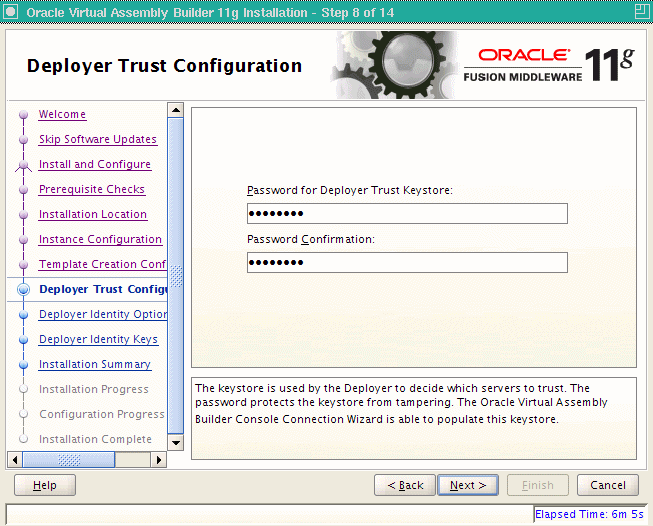

Figure 2-9 Deployer Trust Configuration page
Deployer Trust Configuration. The Deployer uses this keystore to identify trusted servers.
Enter, and confirm, the password for the Deployer Trust Keystore.

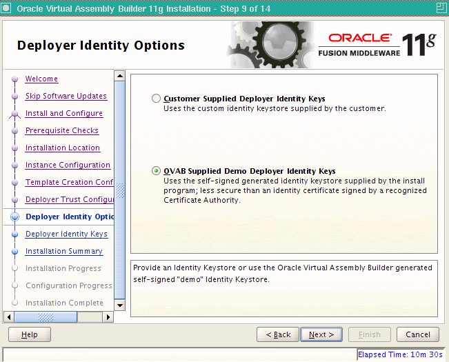

Click Next. The OVAB Supplied Demo Deployer Identity Options page appears.
Figure 2-10 Deployer Identity Options page
Deployer Identity Options. On this page the deployer identity options are required. In order to have a valid SSL connection with Oracle Virtual Machine, the Oracle Virtual Assembly Builder Deployer must provide its identity as part of the connect. You can use your own keystore containing an identity certificate or choose the less secure option of using the Oracle Virtual Assembly Builder-generated self-signed Deployer Identity certificate. The following options are available:

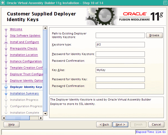

Customer Supplied Deployer Identity Keys: Selecting this option uses the custom identity keystore supplied by you. When you choose Customer Supplied Deployer Identity Keys, the Customer Supplied Deployer Identity Keys page appears.
Customer Supplied Deployer Identity Keys is the default keystore option. It is much more secure than using the demo self-signed certificates.Figure 2-11 Customer Supplied Deployer Identity Keys page
Enter or select:
Path to Existing Deployer Identity Keystore: The location of .jks file.
Keystore Type: Defaulted to JKS (User-modifiable)
Password for Identity Keystore (enter and confirm)
Key Alias: Defaulted to MyKey (User-modifiable)
Identity Key (enter and confirm)

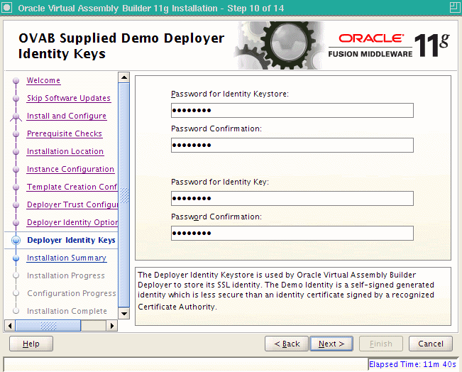

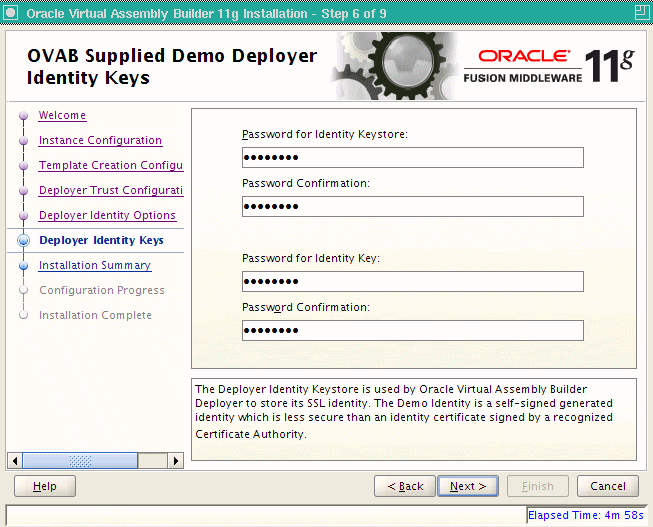

Oracle Virtual Assembly Builder Supplied Demo Deployer Identity Keys: Selecting this option uses the self-signed generated identity keystore supplied by the install program; it is less secure than an identity certificate signed by a recognized Certificate Authority. When you select Oracle Virtual Assembly Builder Supplied Demo Deployer Identity Keys, the Oracle Virtual Assembly Builder Supplied Demo Deployer Identity Keys page appears.
Enter or select:

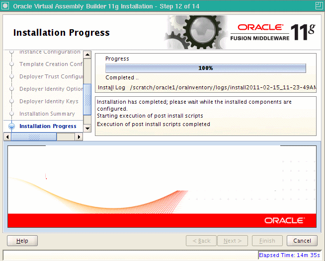

Click Install to start the installation process.
Depending on your selections, an Installation Progress page appears with relevant information.

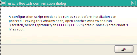

As installation progresses, a pop-up message will appear, instructing you to run a configuration script. Follow the instructions in the message.
Figure 2-15 Configuration script pop-up message
After you run the script, a Configuration Progress page appears.

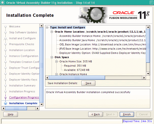

When installation is complete, the Installation Complete page appears.

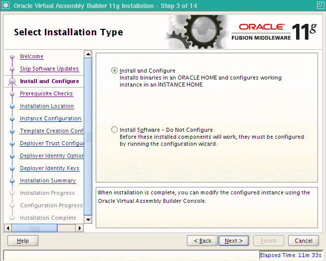

Figure 2-21 Select Installation Type page

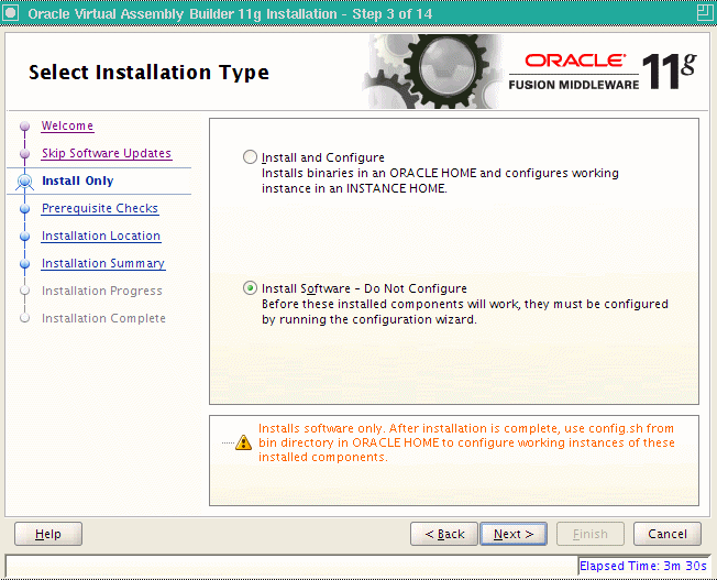

Installation Type. Use this page to choose whether you want to install and configure at this time, or just to install and configure at a later time. Since this section covers install only, choose the Install Software - Do Not Configure radio button.
A message appears reminding you that you'll need to use manual configuration steps later to configure your software. The Prerequisite Checks page appears.

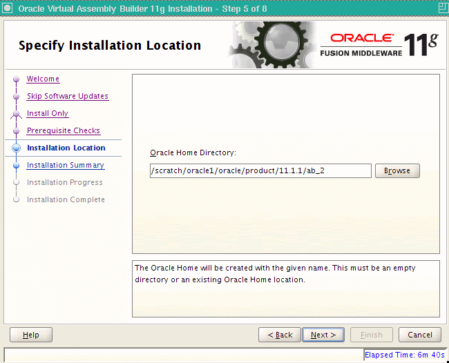

Figure 2-23 Specify Installation Location page

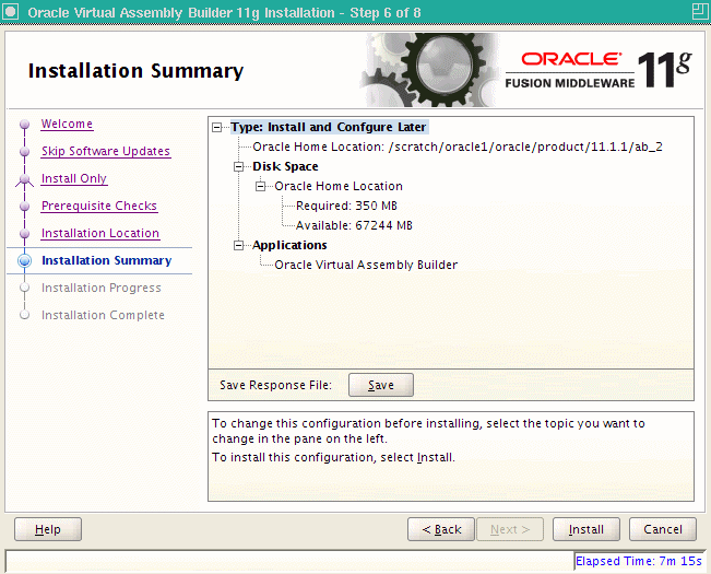

Summary. The Installation Summary page lists the components and locations for install.You can save the response file by clicking Save.
If you want to change any of your installation or configuration choices, you can select the item from the left pane, make the changes, then return to the Installation Summary page.
Click Install to start the installation process. An Installation Progress page appears with relevant information.

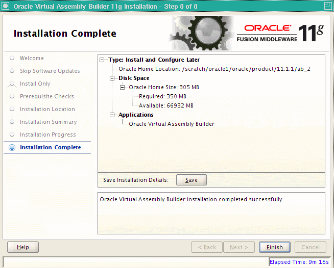

Figure 2-29 Template Creation Configuration page

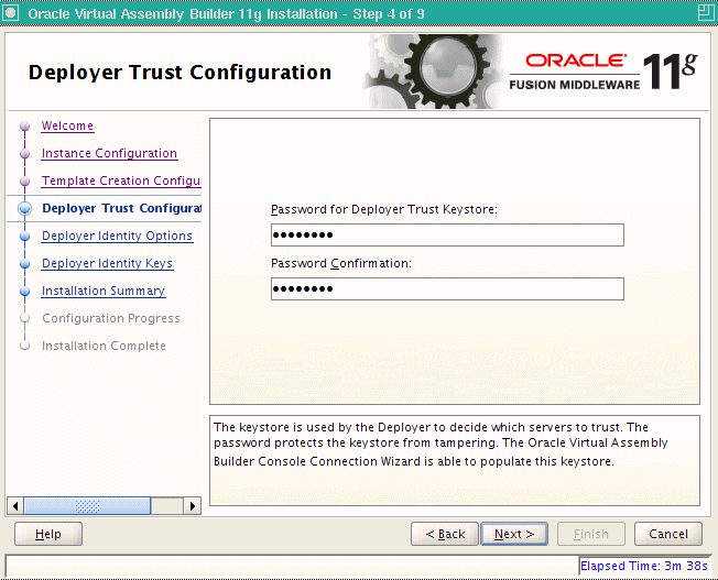

After entering (or selecting) the locations, click Next. The Deployer Trust Configuration page appears.
Figure 2-30 Deployer Trust Configuration page

Figure 2-31 OVAB Supplied Demo Deployer Identity Keys page
Demo Deployer Identity Keys. This screen will appear only if you selected Customer Supplied Deployer Identity Keys in the previous screen. The Keystores are used by the Deployer to store SSL credentials. Select Customer Supplied Deployer Identity Keys (default), or Oracle Virtual Assembly Builder Supplied Demo Deployer Identity Keys.
After choosing your option, click Next. Depending on which option you chose, different pages will appear (for Customer-Supplied or OVAB-Supplied).

If you choose Oracle Virtual Assembly Builder Supplied Demo Deployer Identity Keys enter or select:

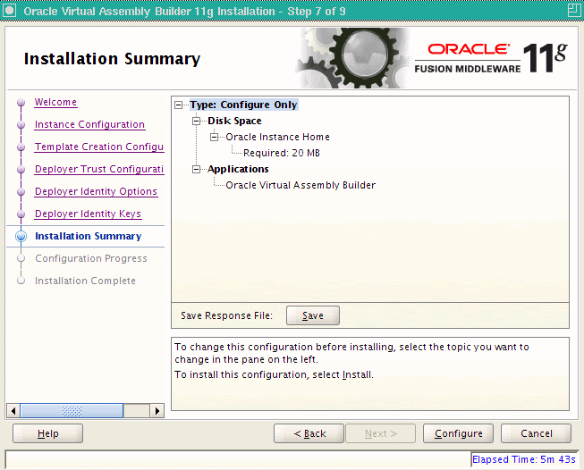

Click Next. The Installation Summary page appears.
If you want to change any of your installation or configuration choices, you can select the item from the left pane, make the changes, then return to the Summary page.

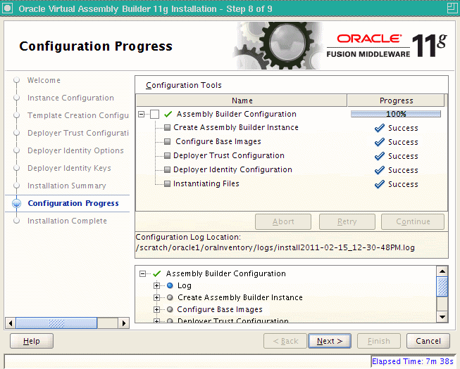

Click Configure to start the configuration process.

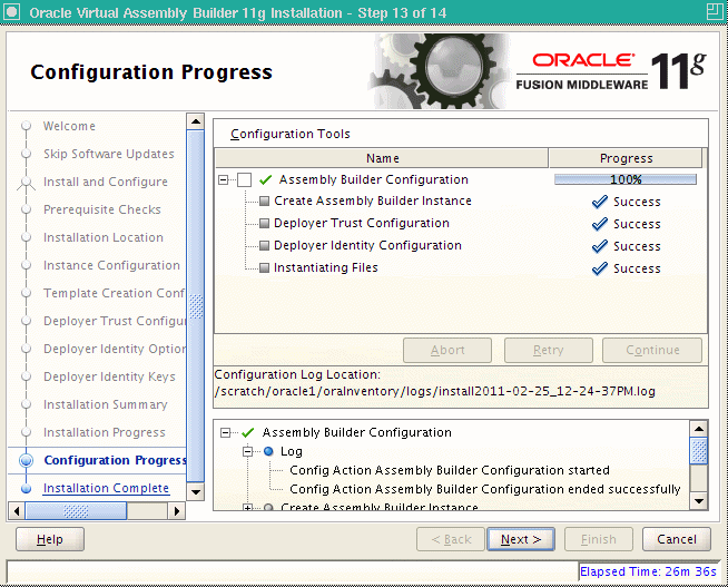

A Configuration Progress page appears.

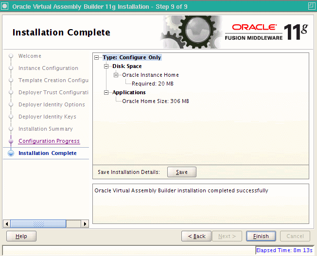

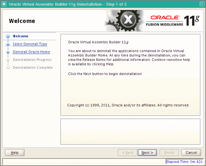

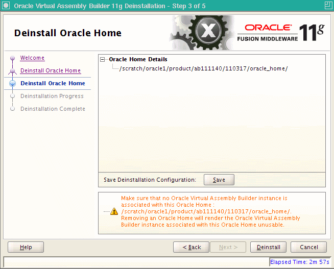

When you execute the deinstall command, Oracle Universal Installer starts. The Welcome page appears.

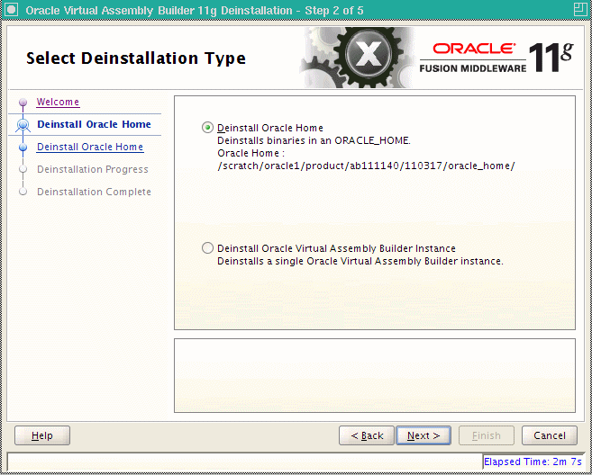

Click Next. The Select Deinstallation Type page appears.
Depending on what you want to deinstall, different pages will appear.

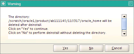

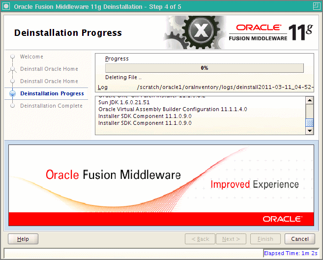

If you choose to deinstall Oracle Home, the Deinstall Oracle Home page appears:
Click Deinstall. A warning appears informing you of the consequences of your actions, and giving you the opportunity to deinstall without removing the Oracle Home.
Figure 2-38 Deinstallation Warning Pop-up
Choose Yes or No. The Deinstallation Progress page appears (see Figure 2-41).

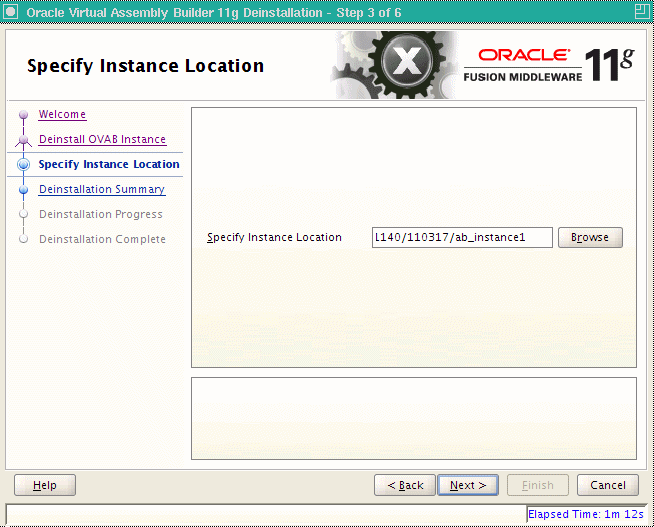

If you choose to deinstall the Oracle Virtual Assembly Builder instance, the Specify Instance Location page appears:
Figure 2-39 Specify Instance Location page
Enter (or browse to and choose) the Oracle Virtual Assembly Builder instance location, then click Next. The Deinstallation Summary page appears.

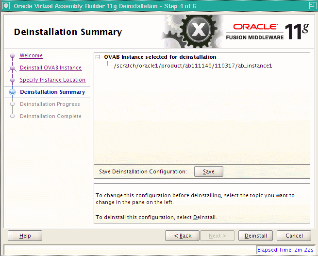

Figure 2-40 Oracle Virtual Assembly Builder Deinstallation Summary page
Click Deinstall. The Deinstallation Progress page appears.
The content of the Deinstallation Progress page varies according to your selections.

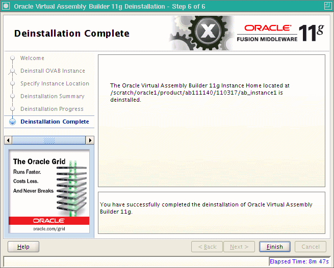

When the deinstallation progress is complete, click Finish. The Deinstallation Complete page appears.
When deinstallation is complete, the Deinstallation Complete page appears. Click Finish.
