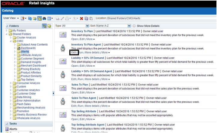

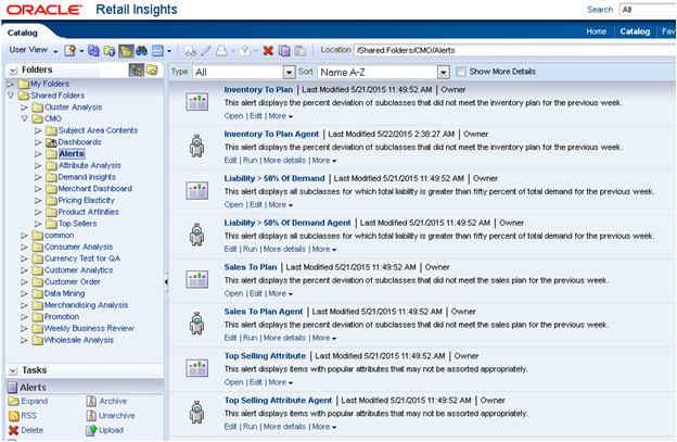

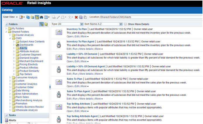

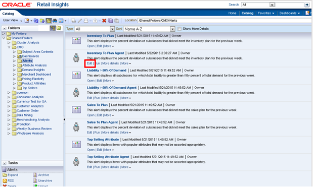

  1. Navigate to Catalog > Shared Folders > CMO >Alerts.
    Figure 8-1 CMO Alerts
    Perform the following steps for each agent (object names ending with agent) present in this folder.
  2. Select the agent object and click Edit.

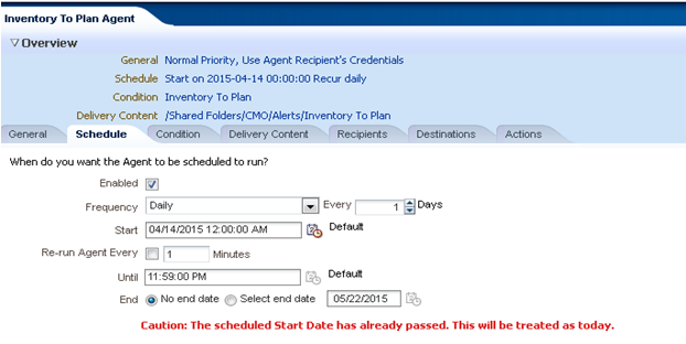

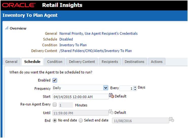

  3. Navigate to the Schedule tab.
    1. On the Schedule tab, check the Enabled checkbox.
    2. Set the Frequency and Start time as shown below to run the alerts daily once.
      Frequency and Start Time should be set according to the implementation preference.
      Figure 8-3 Alerts Schedule Configuration

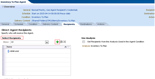

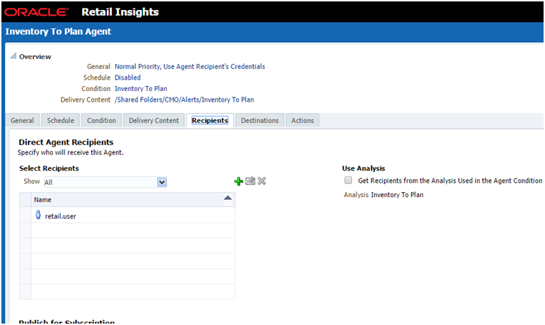

  4. Navigate to the Recipients tab.
    1. From the Recipients tab, click Add under the Select Recipients header and select the users who need to be subscribed for the alert notification.
    Figure 8-4 Alerts Recipients Configuration
