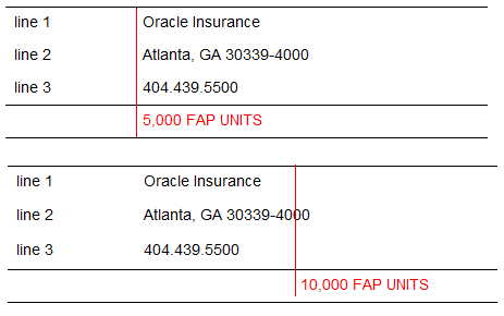

This example centers the original address lines data in the section, QJUSTFIELD2, at 10,000 FAP units.
JustField("C",10000, ,"line 1", , "qjustfield2")
JustField("C",10000, ,"line 2", , "qjustfield2")
JustField("C",10000, ,"line 3", , "qjustfield2")
Here is an example:

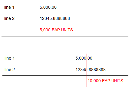

This example justifies the original line data (left aligned at 5,000 FAP units) on the decimal point at 10,000 FAP units.
JustField("C",10000,".","line 1")
JustField("C",10000,".","line 2")
Here is an example:
