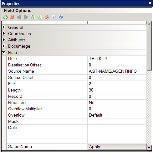

Specify the source file you want the system to search in the File field by entering a number that represents the position of the file in the list. For instance, if you want a field to look something up in the AGENTINFO.TBL file, you would enter two (2) in the File field.
Note The Record property is not part of the XDD layout. If you leave the File property equal to zero (0), the system uses the table index value in the XDD.
Here is an example:
Field options
You can use the Mask field to specify a default look up value. It is not a standard mask like that used in the Move_It rule.
