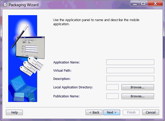

The Application dialog enables you to name a new application and specify its storage location on the mobile server.
Table 6-2 describes the Application dialog.
Table 6-2 Application Dialog Description
| Field Name | Description | Required |
Application Name |
The name of the new mobile application definition. |
Yes |
Virtual Path |
A path that is mapped from the root directory of the server repository to the mobile application itself. The virtual path eliminates the need to refer to the application entire directory structure. It indicates that all of the subdirectories and all of the files that are in the virtual path will be uploaded exactly as they are in the directory structure to the mobile server repository when the application is published. It also provides the application with a unique identity. The name that you enter as the virtual path of the application becomes the application root directory within the mobile server repository, when the application is published. Consequently, you can specify the application root directory by the name that you enter in the virtual path field. This name can be different from the application name, but should not contain spaces. For example, your application name can be 'Sales Office' and your virtual path '/Admin'. In this case, '/Admin' becomes the name of the application root directory within the mobile server repository. The application root directory is the location where the actual application files are stored within the mobile server repository. When the administrator publishes the application, the Packaging Wizard automatically uses the name that you entered in the virtual path as the name of the application root directory in the mobile server repository. However, the administrator can change the name of the application root directory in the mobile server repository by entering a different name for it when the administrator publishes the application. |
Yes |
Description |
A brief description of the mobile application. |
Yes |
Local Application Directory |
The directory on the local machine that contains all components of the application. You can type this location or locate it using the 'Browse' button. During development, the application root directory is set to the local application directory. |
Yes |
Publication Name |
Publication name of an existing application in the mobile server repository. You can enter the publication name or locate it using the Browse button. |
No |
Click Next to advance to the next screen.

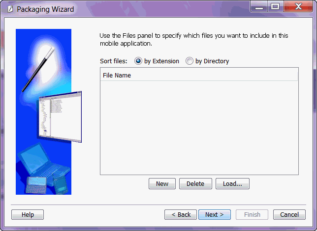

Use the Files screen to list your application files and to specify their location on the local machine. The Packaging Wizard analyzes the contents of the Local Application Directory and displays each file's local path.
Figure 6-4 displays the Files screen.
Table 6-3 Files Tab Description
| Field | Description | Required |
Local Path |
The absolute path of each mobile application file. Each entry on the list includes the complete path of the individual file or directory. |
Yes |
You can add, remove, load, or compile any of the files that are listed in the 'Files' dialog. If you are creating a new application, the Packaging Wizard automatically analyzes and loads all files listed under the local directory when you proceed to the 'Files' dialog. If you are editing an existing application, upload your individual application files using the 'Load' button.

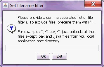

When you click the 'Load' button, the 'Input' dialog appears. You can use the 'Input' dialog to create a comma-separated list of filters that either include or exclude application files from the upload process. To exclude a file, type a preceding minus sign (-) before the file name. For example, to load all files but exclude files with the .bak and .java suffixes, enter the following.
*,-*.bak,-*.java
Figure 6-5 displays the Input dialog.

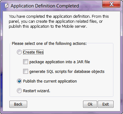

Once you have loaded all relevant files, click Finish to complete the packaging and start the publishing of your application.
Once the packaging is complete, the Packaging Wizard brings up the following screen, so you can choose whether to start the publishing or to complete the packaging to be published at another time.
On this screen, you can choose one of the following:
Create files: You can package all of the information you have gathered for the application and its files into a JAR file and you can generate all scripts for the application's database objects. This JAR file can be used at a future date to be published to any mobile server repository.
If chosen, you will be asked for a location on where to store the JAR file.
Publish the current application: This publishes all of the information you have gathered for the application and its files directly to the mobile server repository.
If chosen, you will be prompted for the URL, user name and password for the mobile server repository. You will also be asked for the repository directory and if you want to make this application public.
Restart wizard: This does not save any of your work for this application and starts the Packaging Wizard without any saved data.
