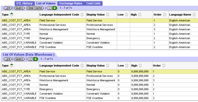

Use the List of Values view, shown in the figure below, to visually compare how the list of values data extracted from the Oracle Business Analytics Warehouse coordinates with the values loaded into the Oracle Business Analytics Warehouse. The ETL process removes duplicates and overlaps and fills data gaps. Values are extended to span the List of Values (LOV) minimum and maximum values. Duplicates, Range Gaps, and Overlaps are flagged by the exception reports.
The top List of Values list shows values from the Oracle Business Analytics Warehouse and the bottom List of Values (Data Warehouse) list shows the data that is to be used in ETL process. You can edit the Oracle Business Analytics Warehouse data directly in this view, but the Oracle Business Analytics Warehouse list is read-only.
