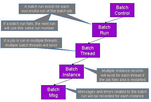

The following diagram illustrates the relationships that
exist for batch control records.
Results of each batch run can be viewed using the
Batch Run Tree page.
