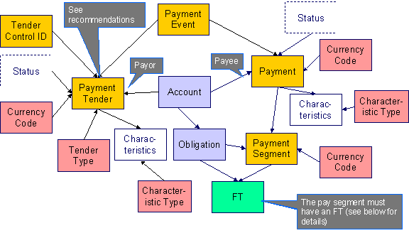

The following data model illustrates the payment object.
The following data model illustrates the FT that must be associated with a payment segment.
Data Model Name |
Table Name |
Generated Keys |
Referential Integrity Validation Batch Control |
Key Assignment Batch Control |
Insertion Batch Control |
Payment |
YesCI_PAY_K |
CIPVPAYV |
CIPVPAYK |
CIPVPAYI |
Payment Characteristic |
No. The key is PAY_ID, plus a sequence number and a char type |
CIPVPYCV |
CIPVPYCI |
Payment Event |
CIPVPYEK |
CIPVPYEI |
Payment Tender |
CIPVTNDV |
CIPVTNDK |
CIPVTNDI |
Payment Tender Characteristic |
No. The key is PAY_TENDER_ID, plus a sequence number and a char type |
CIPVTNCV |
CIPVTNCI |
Payment Segment |
Yes CI_PAY_SEG_K |
CIPVPSGV |
CIPVPSGK |
CIPVPSGI |
FT (financial transaction) |
Yes CI_FT_K |
CIPVFTFV |
CIPVFTXK |
CIPVFTFI See Optional FK Note below. |
FT Characteristic |
No. The key is FT id, char type code and a sequence number |
CIPVFTCV |
CIPVFTCI |
FT GL (FT general ledger) |
No. The key is FT id and a GL sequence number |
CIPVFTGV |
CIPVFTGI |
The SEQ_NUM field on the payment should be left blank. This is part of the primary key for the Payment Event Distribution Details, which are not part of the conversion process.
We recommend that you use the system to create a single deposit control and link to it a single tender control using the PRODUCTION tables. The tender control should reference a tender source of "conversion". Use the prime key of the tender control as the foreign key on the tenders that you insert into the STAGING tables. This means you will have an invalid foreign key relationship on CI_PAY_TNDR (it will reference a tender control that doesn't exist).
After converting the payments:
Re-access the tender control in production and enter the appropriate amounts (per tender type) to balance the tender control.
Re-access the deposit control in production and enter the appropriate amounts to balance the deposit control.

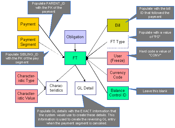

Please populate the columns on the FT that's associated with the payment segment as follows:
CUR_AMT should be set equal to the payment segment amount
PAY_AMT should be set equal to the payment segment amount
CRE_DTTM should be set equal to the payment segment date / time
FREEZE_SW should be "Y"
FREEZE_DTTM should be set equal to the payment segment date / time
ARS_DT should be set equal to the payment segment date
CORRECTION_SW should be "N"
REDUNDANT_SW should be "N"
NEW_DEBIT_SW should be "N"
NOT_IN_ARS_SW should be set to "N"
SHOW_ON_BILL_SW should be set to "N" on all payments other than payments that have been received since the last bill. For recent payments that you want to show on the next bill, this switch must be "Y"
ACCOUNTING_DT should be set to the current date
SCHED_DISTRIB_DT should be left blank
CURRENCY_CD should be the currency on the installation record
BAL_CTL_GRP_ID should be left blank
XFERRED_OUT_SW should be set to "Y"
PARENT_ID should be set to the payment ID
SIBLING_ID should be set to the payment segment ID
Do NOT create any GL details for the FT. If GL details are converted, ensure they are populated with the EXACT information the system would use to create them. This information is used to create the reversing GL entry when the payment segment is canceled.
FTs for adjustments have an optional foreign key BILL_ID to the Bill (CI_BILL) table. If your implementation is planning to convert financial transactions for adjustments, but does not plan to convert bills, the key generation program for Bill must still be run. Refer to The Big Picture of Key Assignment for more information.
