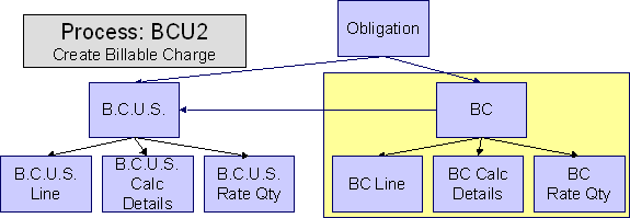

This process creates a billable charge and billable charge lines (shown in the yellow section of the following ERD) for all BC upload records in the Pending state.
Create Billable Charge
If the billable charge's obligation is Closed, it will Reactivate it so that the billable charges will be swept onto the next bill produced for the account.

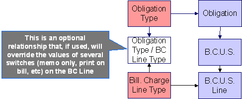

This process will override the values of the various switches referenced on bill charge upload staging line if the respective obligation's obligation type has an override value for the line's billable charge line type. Refer to Obligation Type - Billable Charge Overrides for more information.
Obligation Type BC Override ERD
