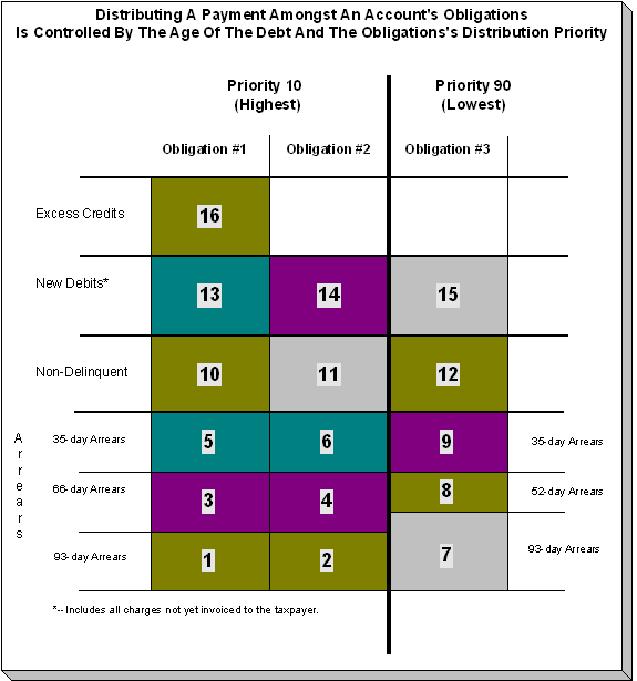

The following diagram helps illustrate how the distribution algorithm works.

The above example shows three columns, one for each obligation linked to a hypothetical account. Notice that two of the obligations have the same distribution priority, the third has a lower priority. The numbers in the cells indicate the order in which the system distributes a partial payment.

The system pays off delinquent debt of the highest priority obligations first. In the above example, where multiple obligations have the same distribution priority, the system does NOT payoff one obligation before it starts on the next (which one would it pick?). Rather, it distributes the payment amongst the obligations based on the age of the respective debt on each obligation. In the above example, this is represented by steps 1 through 6 (notice how the distribution jumps between Obligation #1 and Obligation #2).
After all delinquent debt has been relieved from the highest priority obligation(s), the system pays off the next priority until all delinquent debt is relieved. In the above example, this is represented by steps 7 through 9.
The system next pays off non-delinquent debt using each obligation's respective distribution priority. Note well, the payment distribution algorithm doesn't associate an age with non-delinquent debt and therefore the distribution is based purely on the obligations' respective distribution priority. In the above example, this is represented by steps 10 through 12.
After all non-delinquent debt is relieved, the system next pays off "new debit" debt based on the obligations' respective distribution priority. In the above example, this is represented by steps 13 through 15.
