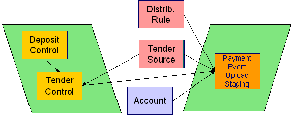

The following diagram and the sections below describe at a high level the processing phases of the C1-PEPL1 background process.

This step creates all tender controls required by the upload records as follows:
For each distinct tender source transmissions represented within the incomplete set of upload staging details a deposit control, a deposit tender and a tender control are created in an open state. Note that a deposit tender record is only created if the tender amount is not zero.
