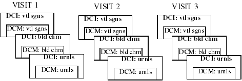

Example 1: Each DCI includes a single DCM. Therefore, entering the data for each visit requires three DCIs.

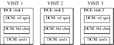

Example 2: One DCI per visit that includes all three DCMs. Therefore, entering the data from each visit requires a single DCI.

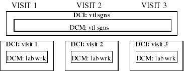

Example 3: One DCI to collect the vital signs for all visits, and a separate one for both of the other DCMs. Therefore, entering the data from each visit requires two DCIs, and one would be ongoing through the study.

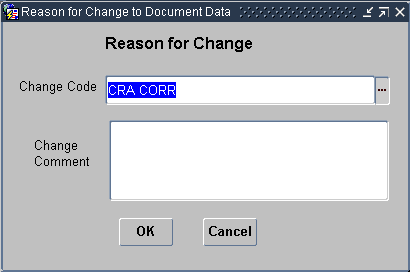

Changes to DCI/DCM in certain statuses cause the system to display the Reason for Change window. Refer to the "Accessibility" section for additional information.
The system displays a Reason for Change window when you update key values or response data in an accessible CRF. The graphic in Figure 1-1 depicts a typical window. The window is comprised of components that allow you to select a change reason and add an optional comment. When the window opens, a default change reason is displayed in the Change Code list box. You can either use the default value or use the list of values to select an alternative.
Select Data Entry then, select Key Changes to change header information for any RDCI, whether or not it is accessible. You can also use this option to log-in data. The difference between Key Changes and Log-in is that Key Changes allows you to update accessible documents.
Note that you cannot query in key changes mode. To open an RDCI you must know either the document number or information in the other fields to uniquely identify the RDCI.
To change accessible header information:
Select Data Entry then, select Key Changes. The data entry window opens.
Enter the document number or enter all key information
Click the Commit button.
If the document is accessible (either internally or externally), the system displays the Reason for Change window. Select a change reason code and, if necessary, type an explanatory comment in the Change Comment field.
Save pending changes.
When an RDCI is accessible, you can modify its data in Update mode.
To update response values in a DCM:
From the tree, select Data Entry then, select Update.
Open the appropriate RDCI.
Navigate to the relevant RDCM.
To update accessible data:
Move to the field you want to change and enter the new value.
Move to another field by clicking in it or by pressing Next Field.
If the system detects a univariate error, it displays the Univariate Validation Failure window before allowing you to move to the next field.
If the new value passes univariate validation, select a reason for the change from the list of values in the Audit Change Reason Type window.
The system displays the Reason for Change window.
Optionally, enter a freeform comment describing the reason for the change.
Select Save to save it and return to the Data Entry window.
If necessary, resolve any duplicate or missing records.
Select Save to save all changes and return to the RDCI window.
