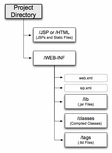

Building a SIP Servlet produces a Web Archive (WAR file or directory) as an end product. A basic SIP Servlet WAR file contains the subdirectories and contents described in Figure C-1.

Right-click on the name of your project and use the New >Folder command to recreate the directory structure shown in Figure C-1, "SIP Servlet WAR Contents".
