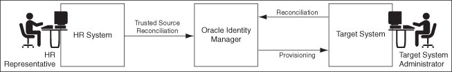

Figure 4-2 shows that provisioning and reconciliation involve synchronization from Oracle Identity Manager to the target system or from the target system to Oracle Identity Manager. Provisioning and reconciliation enable the provisioning system to build the managed identities in the target system as well as replicate the managed identities as they already exist in the target system.
Figure 4-2 Provisioning and Reconciliation
In Figure 4-2, a user is created by the HR representative when a new employee joins. The user is reconciled to Oracle Identity Manager by trusted source reconciliation. When the user is created in Oracle Identity Manager, the account for the user is provisioned in the target system. In the target system, the target system administrator can make changes in the account, which must be reconciled to Oracle Identity Manager.
In terms of data flow, provisioning provides the outward flow from the provisioning system by using a push model, in which the provisioning system indicates the changes to be made to the target system. Reconciliation provides the inward flow into the provisioning system by using either a push or a pull model, by which the provisioning system finds out about any activity on the target system.

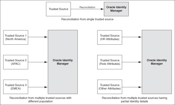

If data is reconciled from a system that drives the creation of users, roles, role memberships, or role hierarchies in Oracle Identity Manager repository, then that reconciliation mode is called identity reconciliation, or authoritative source reconciliation, or trusted source reconciliation. The system that is being reconciled from is referred to as the authoritative source for the enterprise identities, and may be an HR system or a corporate directory.
As shown in Figure 4-3, the authoritative sources of identity may be more than one. The different authoritative sources may be the source of reconciliation for different categories of user identities or may be the source of reconciliation for different sets of attributes. The various events generated by the reconciliation engine are add, modify, and delete.
Figure 4-3 Trusted Source Reconciliation from Single and Multiple Authoritative Sources
In Figure 4-3, trusted source reconciliation from a single authoritative source and multiple authoritative sources are shown. Creation of user entities can be reconciled from multiple authoritative sources. In addition, different attributes can be reconciled from different multiple authoritative sources. For example, the user ID and e-mail ID can be provided by an authoritative source and role attributes can be provided by another authoritative source.

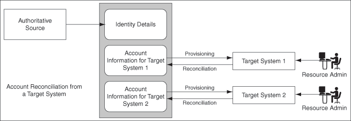

If the target system identities are accounts that get reconciled to Oracle Identity Manager, then that is target resource reconciliation or account reconciliation. This type of reconciliation is to reconcile a specific resource object that represents the target system being managed. There is always a corresponding provisioning flow for it. The identity retrieved from the target system maps to a resource object instance that has been provisioned to a user or organization.
Account reconciliation takes place in the following scenarios:
Scenario I
Identity gets created in Oracle Identity Manager from an authoritative source. The identities are provisioned with resources on the target system. Any change on the target system is reconciled with Oracle Identity Manager. Figure 4-4 shows account reconciliation from a target system:
Figure 4-4 Account Reconciliation From a Target System

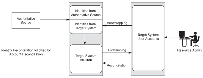

Figure 4-5 shows identity reconciliation followed by account reconciliation:
Figure 4-5 Identity and Account Reconciliation

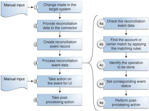

The reconciliation process flow is shown in Figure 4-6:
Reconciliation process involves the following steps:
Changes in the target system: The various activities that can happen in the target system are creation, modification, or deletion of user, account, role, role membership, or role hierarchy.
Note: If you create an entity on an external system and then modify it a short time later, reconciliation processes the create entity step, but the modify entity step fails with the Creation Failed event status. This is because reconciliation cannot process a create and a modify action for the same entity in the same batch process.However, the entity modification action can be resubmitted for reconciliation at a later time by one of the following built-in mechanisms:
Reconciliation failure messages that are caused by processing conflicts within the same batch process should be regarded as transitory failures only. |
Providing reconciliation data: When the creation, modification, or deletion event occurs, data about that event is sent to the reconciliation service by using reconciliation APIs.
Note: Reconciliation service refers to the collection of reconciliation engine, reconciliation APIs, and the associated metadata and schema. |
Creation of reconciliation event record: When the data for a reconciliation event is provided to reconciliation service, a record of that event is stored in Oracle Identity Manager repository.
Processing of the reconciliation event data: The data received is then evaluated to determine the actual operation to be performed in Oracle Identity Manager based on the changes in the target system. The evaluation involves application of a specific set of rules that help in:
Identifying whether the data is for an account or for an identity that Oracle Identity Manager already has a record of
Identifying the owner of the account or identity that the data represents
Defining the context-sensitive action to be taken
Setting the status of the event at the end of evaluation and the action that the reconciliation engine must take
Taking action on the event: Based on the evaluation result of processing the reconciliation event data, the intended action is taken. The various actions can be:

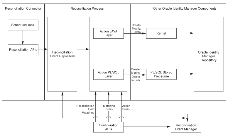

Reconciliation is the process of pulling entity data from the target system into Oracle Identity Manager to keep the entity data in a consistent state between the two systems. The various components of Oracle Identity Manager involved in reconciliation and the interaction between these components are shown in the Figure 4-7:
The reconciliation architecture is described in the following steps:
Each connector has scheduled tasks associated with it. The scheduler triggers the connector scheduled task, which invokes reconciliation APIs to generate events. The event can be of type Regular, Changelog, or Delete. For more information about the scheduler, see "Managing Scheduled Tasks" for information about the Scheduler in the Oracle Fusion Middleware System Administrator's Guide for Oracle Identity Manager. For more information about scheduled tasks, see "Connector for Reconciliation".
The reconciliation events are stored in the reconciliation event repository, which is Oracle Identity Manager database.
When batch size is met, an asynchronous message is submitted which processes the batch of events in bulk. At the end of the schedule task another asynchronous message is submitted for processing the events of the last batch. For information about the matching module, see "Matching Module".
The processing involves data validation, matching of the entities and action (create, update, delete and so on). This is followed by post processing via kernel orchestrations. For information about the action module, see "Action Module". For information about the reconciliation profile, see "New Metadata Model-Profile" in the Oracle Fusion Middleware System Administrator's Guide for Oracle Identity Manager.
By default the reconciliation event processing happens in bulk, and therefore all the steps till post processing are performed by PL/SQL stored procedures. Event can be processed one at a time in the following scenarios (in this case all the steps till matching are done in PL/SQL and the action is performed in java layer):
When events are processed from the Reconciliation Management console
When failed events are retried by the retry scheduled task that runs periodically
For reconciliation single event processing, actions and post processing take place through the kernel.
Reconciliation events are made available to the Reconciliation Management console by another API call in the reconciliation management service.

Event Received |
A reconciliation event has been created and is ready for further processing. The finishReconciliationEvent API has not yet been called. |
Data Validation Failed |
The reconciliation event record is invalid. For example, a role event with an invalid role category will fail to validate. (This situation could indicate a race condition.) The RE_NOTE field should contain the details of the failure, which is also displayed in the user interface. |
Data Validation Succeeded |
The event data was successfully validated and the event can now safely be processed by the Engine. |
Multiple Accounts Match Found |
Given the current matching rules, multiple matching account records were found for the data. |
No Account Match Found |
Given the current matching rules, no matching account records were found for the data. |
Single Account Match Found |
Given the current matching rules, one matching account record was found for the data. |
Multiple Org Matches Found |
Given the current matching rules, multiple matching organization records were found for the data. |
No Org Match Found |
Given the current matching rules, no matching organization records were found for the data. |
Single Org Match Found |
Given the current matching rules, one matching organization record was found for the data. |
Multiple Role Grants Match Found |
Multiple matching records for user membership within a role were found. |
No Role Grant Match Found |
No matching records for user membership within a role were found. |
Single Role Grant Match Found |
One matching record for user membership within a role was found. |
Multiple Roles Match Found |
Given the current matching rules, multiple matching role records were found for the data. |
No Role Match Found |
Given the current matching rules, no matching role records were found for the data. |
Single Role Match Found |
Given the current matching rules, one matching role record was found for the data. |
No Role Members Found |
The Reconciliation Engine did not find role members matching the data, given the current matching rules. |
No Role Parent Found |
The Reconciliation Engine did not find a role matching the data, given the current matching rules. |
Multiple Role Relationships Match Found |
Given the current matching rules, reconciliation has found multiple role-to-role relationships that match data in the event. |
No Role Relationship Match Found |
Given the current matching rules, reconciliation did not find any role-to-role relationships that match data in the event. |
Single Role Relationship Match Found |
Given the current matching rules, reconciliation has found one role-to-role relationship that matches data in the event. |
Multiple Users Match Found |
Given the current matching rules, multiple matching user records were found for the data. |
No User Match Found |
Given the current matching rules, no matching user records were found for the data. |
Single User Match Found |
Given the current matching rules, one matching user record was found for the data. |
Invalid Event Data Passed |
The event contains invalid data. This status pertains to the e-mail attribute. |
Being Re-evaluated |
The reconciliation event is being reevaluated from the reconciliation management console. |
Being Re-tried |
The reconciliation event is being retried automatically. This status event has been deprecated. |
Creation Failed |
The user/account/role entity was not created successfully. |
Creation Succeeded |
The user/account/role entity was created successfully. |
Delete Failed |
The user/account/role entity was not successfully deleted. |
Delete Succeeded |
The user/account/role entity was deleted successfully. |
Event Closed |
The reconciliation event was closed from the reconciliation management console. The change is complete. |
Update Failed |
The user/account/role entity was not updated successfully. |
Update Succeeded |
The user/account/role entity was updated successfully. |
This module applies the action based on the event state, entity type, and the action rules, as listed in Table 4-4:
Table 4-4 Action Rules
| Event State | Entity Type | Action | Description |
User |
No Action |
Does not perform any action |
Create User |
Creates a user in Oracle Identity Manager |
Account |
No Action |
User Matched |
User or Account |
No Action |
User |
Establish Link |
Modifies or deletes the matched user based on the change type |
Account |
Establish Link |
Owner identified - creates an account |
Users Matched |
User or Account |
No Action |
Account Matched |
Account |
No Action |
Does not perform an action |
Establish Link |
Modifies or revokes the account based on the change type |
Accounts Matched |
No Action |
Role |
No Action |
Role |
No Action |
Establish Link |
Modify or delete a role |
Role Membership |
Create role membership |
Grant a role member to Oracle Identity Manager |
Delete role membership |
Delete a role member from Oracle Identity Manager |
No action |
Role Hierarchy |
Create role hierarchy |
Creates a role hierarchy in Oracle Identity Manager |
Delete role hierarchy |
Delete a role hierarchy in Oracle Identity Manager |
No action |
Multiple Roles Matched |
Role, Role membership and Role Hierarchy |
No action |
Role Membership |
No Action |
Create Role Member |
Creates a role member in Oracle Identity Manager |
Role Membership |
No action |
Establish Link |
Delete role member |
Multiple Role Grant Match Found |
Role Membership |
No action |
Does not perform an action Note: This state does not occur because the role grant match is done by looking for the primary key, which is a combination of the usr key and the group key. |
No Role Parent Match Found |
Role Hierarchy |
No Action |
Create role parent |
Create a role parent in Oracle Identity Manager |
Single Role Parent Match Found |
Role Hierarchy |
No Action |
Establish Link |
Delete role parent |
Multiple Role Parent Match Found |
Role Hierarchy |
No Action |
Role, Role Hierarchy, Role Member |
Race condition |
Does not perform an action. The event needs to be re-evaluated. |
Parent role not found |
Role Hierarchy |
Race condition |
Role member not found |
Role membership |
Race condition |

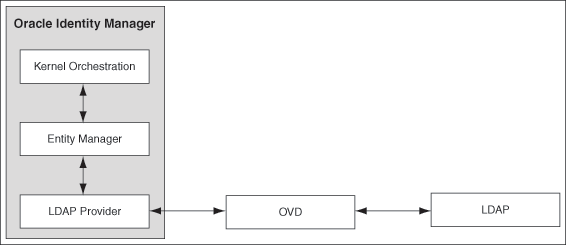

When changes are made in the user and role data, the actual operation is performed with the help of the kernel handlers. These handlers go through an orchestration lifecycle of various stages, such as validation, preprocessing, action, and postprocessing. For more information about the various stages of kernel orchestration, see Oracle Fusion Middleware Developer's Guide for Oracle Identity Manager.
Oracle Identity Manager kernel orchestration connects to the Entity Manager, which in turn connects to the LDAP provider. The LDAP provider connects to Oracle Virtual Directory (OVD). The OVD is an interface to various directory systems, such as Oracle Internet Directory, iPlanet, and Active Directory. The LDAP provider reaches the LDAP data by using OVD. Figure 4-8 shows the communication between Oracle Identity Manager and LDAP:
Figure 4-8 Oracle Identity Manager and LDAP
The integration configuration and synchronization of data between Oracle Identity Manager and the LDAP identity store are described in the following sections:
