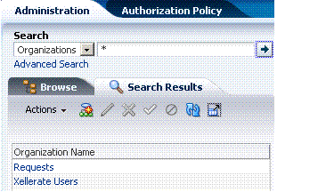

The simple search operation lets you search organization entities based on the search strings that you specify as search attributes. This operation is also referred to as simple search or quick search.
To perform a simple search for organizations:
Login to Oracle Identity Administration.
In the Administration tab on the left pane, from the drop-down list, select Organizations.
In the Search field, enter an organization name as a search criterion. You can include wildcard characters (*) in your search criterion. For performance reasons, initial (prefix) wildcards will be removed. However, a trailing (prefix) wildcard will be added to all searches.
Click the search icon. In the Search Results tab, the search result is displayed in a table that shows the organization names that matched the search criterion. Figure 13-2 shows the search results table:

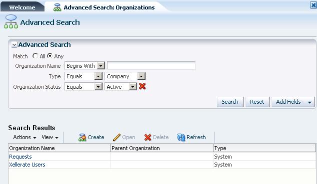

Advanced search for organizations allows you to specify more complex search criteria than the simple search operation. The results are displayed in search results table.
To perform advanced search for organizations:
In the Welcome page, under Organizations, click Advanced Search - Organizations. The Advanced Search page is displayed on the right pane.
Select any one of the following:
All: Search is performed with the AND condition. This means that the search operation is successful only when all the search criteria specified are matched.
Any: Search is performed with the OR condition. This means that the search operation is successful when any search criterion specified is matched.
In the Organization Name field, enter the organization name search attribute that you want to search. To do so, select a search comparator. The default search comparator is "Begins With". The comparator "Equals" is available in the pulldown list as an alternative. See "Search Comparators" for more information about search comparators.
You can use wildcard characters to specify the organization name.
From the Organization Customer Type list, select the organization type. The organization type can be Branch, Department, or Company.
From the Add Fields button, select Organization Status.
From the Organization Status list, select the organization status, which can be Active, Deleted, or Disabled.
Click Search. The results are displayed in the search results table, as shown in Figure 13-3. The search results table displays the organization name, parent organization, organization customer type, and organization status.

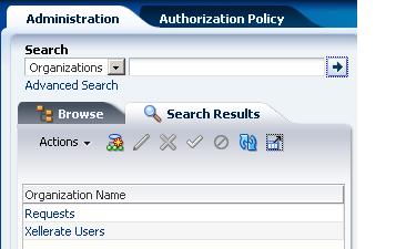

You can browse data in the Organizations section in Oracle Identity Manager Administration. The browse functionality is available in the left pane of the UI.
Using the browse operation, you can navigate through the organization tree in the system, starting at the root organization. If there are multiple organization trees, then all the trees are displayed. Each tree starts at a root organization node, which has no parent organization. The users defined in the organization are not displayed as nodes in the tree.
To browse through organizations, in the left pane of Oracle Identity Manager Administration, under the Browse tab, click Organization. All the organizations in Oracle Identity Manager are displayed in the browse list, as shown in Figure 13-4:
The organization browse list shows the organizations trees with the root and child organizations.
In the organization browse list, you can perform the following:

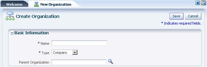

Figure 13-5 shows the Create Organization page.
Enter values in the fields in the Create Organization page. Table 13-2 lists the fields in the Create Organization page:
In the Name field, enter the name of the organization.
In the Type field, select the type of the organization, such as Company, Department, or Branch.
Specify the parent organization to which the newly created organization will belong. To do so:
Click the search icon next to the Parent Organization field. The Search: Organizations dialog box is displayed, as shown in Figure 13-6:
Figure 13-6 The Search: Organizations Dialog Box
Select any one of the following options:
All: On selecting this option, the search is performed with the AND condition. This means that the search operation is successful only when all the search criteria specified are matched.
Any: On selecting this option, the search is performed with the OR condition. This means that the search operation is successful when any search criterion specified is matched.
In the Organization Name field, enter the organization name that you want to search. You can use wildcard characters in your search criteria. Select a search condition in the list adjacent to the Organization Name field. The search conditions include "Equals" or "Begins With".
In the Organization Customer Type field, enter the organization type of the parent organization. You can use wildcard characters in your search criteria. Select a search condition in the list adjacent to the Organization Customer Type field.
Click Search. The organizations that match the search criteria you specified are displayed in the search results table.
From the search results table, select the organization that you want to specify as the parent organization.
Click Finish. The selected organization is added as the parent organization.
Click Save to create the organization.

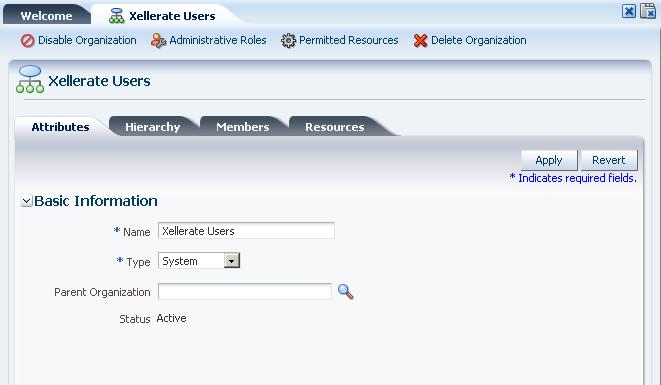

The organization details page is displayed, as shown in Figure 13-7:
Figure 13-7 The Organization Details Page
You can perform administrative organization modifications in the organization details page. The modification is divided across the different sections of the organization details page, which means that modifications done in each section are independent of each other and must be saved individually. The modification for each section is described in the following sections:
Note: You must have "organization create" permission to update or delete organizations. |
The Attributes tab, as shown in Figure 13-7, of the organization details page displays attributes of the organization. If you are authorized to modify the organization profile as determined by authorization policy on the Modify Organization Profile privilege, then the organization details page opens in editable mode and you can modify organization information. You can modify the values for the attributes, and then click Save to save the changes.
Whether or not the logged-in user is allowed to modify the organization is controlled by authorization policies. If you are not allowed to modify the organization, then the organization details page is displayed in read-only mode with no editable fields. See "Organization Management Authorization" for information about authorization of the organization management feature.
Note: The Status attribute in the organization details page is read-only. |

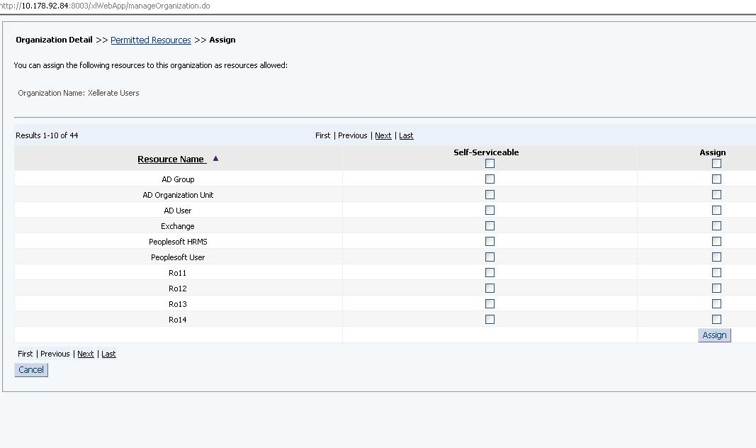

The Resources tab displays the permitted resources for the selected organization. You can select one or multiple resources in the list, and then perform the following:
To provision resources to the organization:
From the Actions menu, select Provision. Alternatively, click Provision on the toolbar. This brings up a wizard " Step 1: Select a Resource".
Search for the resource that you want to provision. Select the resource and click Continue.
In the Step 2: Verify Resource Selection page, the resource that you selected for adding to the organization is displayed. Verify the information and click Continue. Provisioning the selected resource to the organization starts.
Close the Provision Resource to Organization wizard. The resource is added to the Hierarchy tab.
Tip: If the provisioned resource is not displayed in the Hierarchy tab, then click Refresh on the toolbar. |

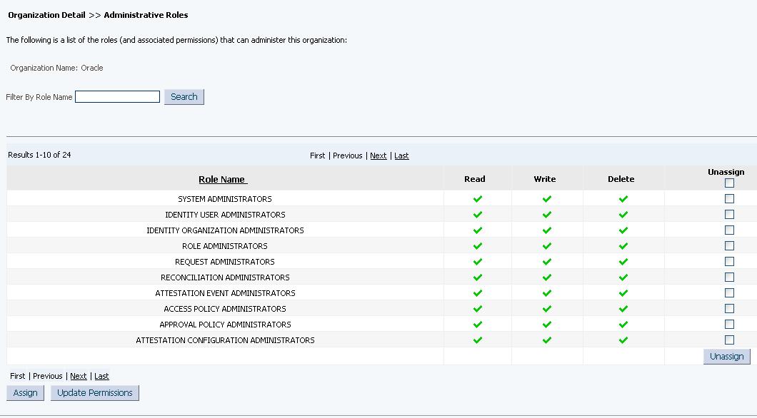

In the organization detail page, click Administrative Roles.
On the Administrative Roles page, in the Filter By Role Name, enter a search criterion to search for administrative roles that can administer the organization. Then, click Search. A list of roles with associated permissions are displayed.
To unassign any role from the organization, select the Unassign option to the right of the administrative role, and click Unassign.
To assign an administrative role to the organization:
Click Assign. The Assign page is displayed with a list of available roles.
You can filter the role names by entering a search criteria in the Filter By Role Name box, and clicking Find.
Note that the Read options are selected by default for all the roles.
Select the Write, Delete, and Assign options for the administrative roles to provide write, delete, and assign administrative permissions respectively.
Click Assign.
To update permissions for the administrative roles:
Click Update Permissions. The Update page is displayed with a list of administrative roles, whose permissions you can modify.
Select or deselect the Write and Delete options for the administrative roles to modify the write and delete permissions respectively.
Click Update.
When finished, close the Administrative Roles page. Figure 13-8 shows the Administrative Roles page.
The Permitted Resources page allows you to assign and update a list of permitted resources to the users of the selected organization.
To assign permitted resources to the users in the selected organization:
In the Browse tab on the left pane, select an organization. From the Actions menu, select Open.
In the organization detail page, click Permitted Resources.
In the Permitted Resources page, select the resources and click Assign.
To update the resources allowed to the selected organization:
In the Permitted Resources page, select the resources and click Update.
Figure 13-9 shows the Assign Permitted Resources page.
