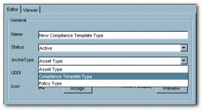

  5. Open the new compliance template type in the Type Manager.
  6. Click the Editor tab of new compliance template type.
  7. Select Compliance Template Type in the Archetype list in the General section of the Editor tab, as shown in Figure 11-3.
  8. Click Save in the File menu.

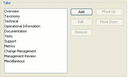

  9. Select one of the of the tabs listed in the Tabs section, as show in Figure 11-4.
    The elements assigned to that tab appear in the list in the Elements section.

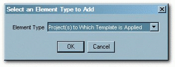

  10. Click the Add button in the Elements section. The Select an Element Type to Add dialog is displayed, as shown in Figure 11-5.
    Figure 11-5 Select an Element Type to Add Dialog
    Description of Figure 11-5 follows
    Description of "Figure 11-5 Select an Element Type to Add Dialog"
  11. Select Project(s) to Which Template is Applied from the list in the Select an Element Type to Add dialog.
  12. Click OK. The Select an Element Type to Add closes.

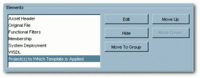

  14. Click OK. The new elements is displayed in the list in the Elements section.

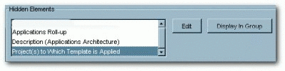

  17. Locate and select the new element in the list of Hidden Elements, as shown in Figure 11-7.
    Figure 11-7 Hidden Elements Section
    Description of Figure 11-7 follows
    Description of "Figure 11-7 Hidden Elements Section"

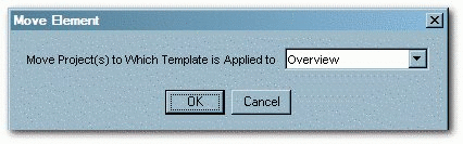

  18. Click the Display in Group button. The Move Element dialog is displayed, as shown in Figure 11-8.
    Figure 11-8 Move Element Dialog
    Description of Figure 11-8 follows
    Description of "Figure 11-8 Move Element Dialog"
  19. Use the list in the Move Element dialog to select a location for the new element.
  20. Click OK. The new element is displayed in the list in the Elements section of the Viewer tab.
    Figure 11-9 Elements Section
    Description of Figure 11-9 follows
    Description of "Figure 11-9 Elements Section"

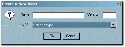

  1. Select New in the File menu. The Create a New Asset dialog is displayed, as shown in Figure 11-10.
    Figure 11-10 Create a New Asset Dialog
    Description of Figure 11-10 follows
    Description of "Figure 11-10 Create a New Asset Dialog"
  2. Enter the appropriate information in the Name and Version text boxes.
  3. Select the appropriate Type template from the list.

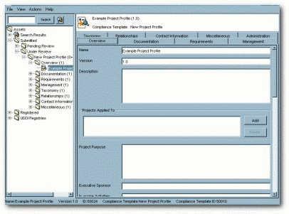

  4. Click OK. The new compliance template is displayed in the Asset Editor, as shown in Figure 11-11.

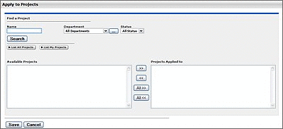

  2. Click Apply to Projects. The Apply to Projects dialog is displayed, as shown in Figure 11-12.
    Figure 11-12 Apply to Projects Dialog
    Description of Figure 11-12 follows
    Description of "Figure 11-12 Apply to Projects Dialog"
  3. Click List All Projects or use Search to locate the project to which the profile is applied. A list is displayed in the Available Projects column.
  4. Select the project to which the profile is applied.
  5. Click the right arrow button to move the project from the Available Projects column to the Projects Applied to column. The project moves from Available Projects to Projects Applied to.

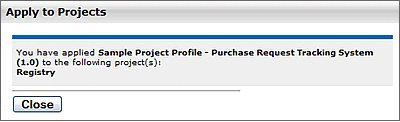

  6. Click Save. A confirmation dialog is displayed, as shown in Figure 11-13.
    Figure 11-13 Apply to Projects Confirmation Dialog
    Description of Figure 11-13 follows
    Description of "Figure 11-13 Apply to Projects Confirmation Dialog"
  7. Click Close.

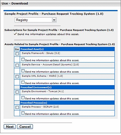

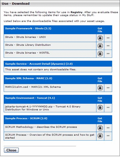

  3. Click Use Assets to the right of the name of the listed compliance template. The Use / Download dialog is displayed, as shown in Figure 11-16.
    Figure 11-16 Use - Download Dialog
    Description of Figure 11-16 follows
    Description of "Figure 11-16 Use - Download Dialog"
    The Use Assets button will appear only to users who are assigned to the project.
  4. Use the options in the Use column to select the assets to be downloaded.
  5. Click the Next button. The Use / Download dialog confirms the asset selections, as shown in Figure 11-17.
    Figure 11-17 Use - Download Dialog
    Description of Figure 11-17 follows
    Description of "Figure 11-17 Use - Download Dialog"
  6. Click the down arrow button to download the payloads for the selected assets.

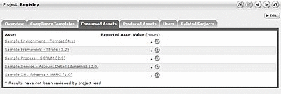

  7. Click Close when finished. The downloaded assets are listed on the Consumed Assets section of the project detail, as shown in Figure 11-18.
    Figure 11-18 Consumed Assets Tab
    Description of Figure 11-18 follows
    Description of "Figure 11-18 Consumed Assets Tab"

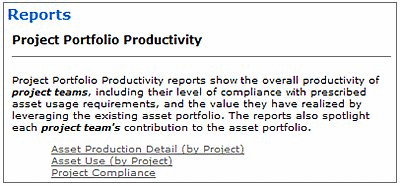

  1. Click the Project Compliance link in the Reports sidebar, as shown in Figure 11-19.
    Figure 11-19 Reports Section
    Description of Figure 11-19 follows
    Description of "Figure 11-19 Reports Section"

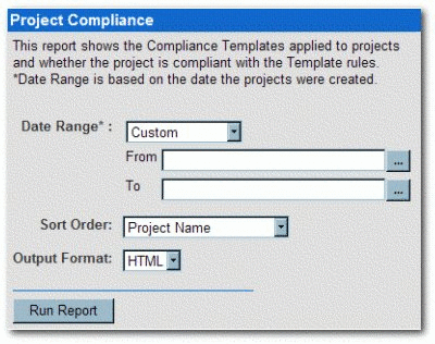

    The Project Compliance report form opens in the main pane, as shown in Figure 11-20.
    Figure 11-20 Project Compliance Report Form
    Description of Figure 11-20 follows
    Description of "Figure 11-20 Project Compliance Report Form"

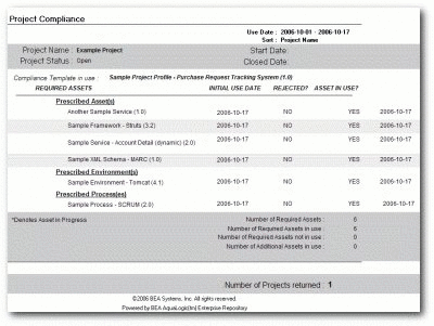

  2. Use the Date Range, Sort Order, and Output Format lists to set the report parameters.
    Date Range is based on the project creation date.
  3. Click the Run Report button. The report is displayed in the selected format, listing each project, and indicating compliance templates in use, prescribed assets, usage status of prescribed assets, and any additional assets consumed by the project, as shown in Figure 11-21.
