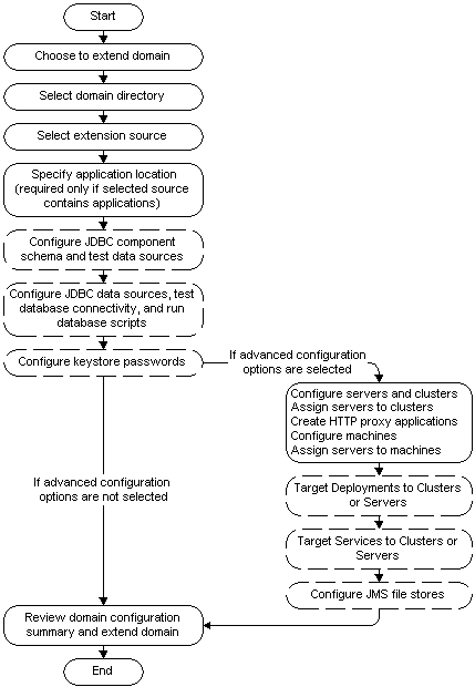

Figure 3-1 summarizes the steps for extending a WebLogic domain by using the Configuration Wizard. The steps indicated in boxes with dashed lines are relevant only when you extend domains to include specific products, such as those that use RCU and those that require JDBC data sources.
Figure 3-1 Extending a WebLogic Domain
Steps to extend a domain
Description of "Figure 3-1 Extending a WebLogic Domain"
