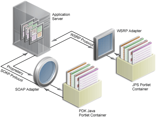

Oracle WebCenter Framework can support communication between the WebCenter Portal application and both the Java Portlet APIs and our existing APIs (PDK-Java).
Figure 55-2 shows the architecture of the WSRP support. Notice that the JSR 286-compliant portlet container uses the WSRP protocol for communication and the PDK-Java portlet container uses Oracle's proprietary SOAP protocol for communication.
Figure 55-2 Oracle WebCenter Portlet Architecture

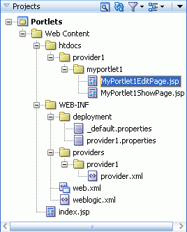

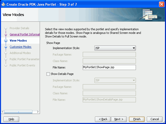

Section 55.2.2, "What Happens When You Create a JSR 286 Java Portlet Using the JDeveloper Wizard"
Section 55.2.5, "What Happens When You Create a PDK-Java Portlet"
Section 55.2.6, "After You Create an Oracle PDK-Java Portlet Using the JDeveloper Wizard"

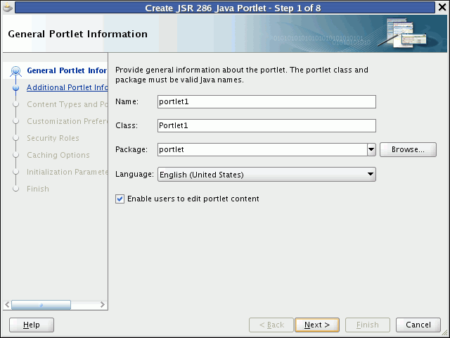

On the General Portlet Information page of the Create JSR 286 Java Portlet wizard (Figure 55-3), replace the default name provided in the Name field with one that better describes the purpose of the portlet.
Figure 55-3 The General Portlet Information Page
In the Class field, enter a name for the class for the portlet. You can accept the default name provided or supply your own. If you supply your own name, it must be a valid Java name.
From the Package enter the name of the package in which to create the class, or select the package from the dropdown list.
Click the Browse button to find packages within the project, if required. If you do not select a specific package, the wizard uses the default package of the project.
From the Default Language dropdown list, select the default language that your portlet supports. The wizard uses English by default.
Select Enable users to edit portlet content if you want your portlet to support Edit mode. In the wizard, this option is selected by default.
Edit mode enables users to personalize the portlet at runtime. For more information, see Section 53.1.3.2, "Edit Mode."
If you select this option, you can specify implementation details for the portlet's Edit mode later on in the wizard.
Click Next.

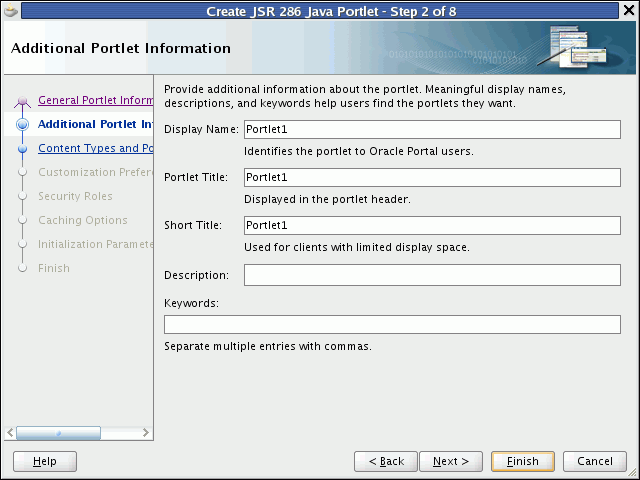

On the Additional Portlet Information page (Figure 55-4), in the Portlet Title field, enter a descriptive title for your portlet.
The portlet title is displayed in the Resource Palette or Application Resources panel, so make the title something to help users decide whether the portlet is useful to them. The portlet title is also displayed on the portlet header when the portlet appears on a page.
Figure 55-4 The Additional Portlet Information Page
The Display Name, Short Title, Description, and Keyword attributes are not implemented in WebCenter Portal applications. You do not need to enter any values for these fields unless your portlet is likely to be consumed by other applications.
For example, Oracle Portal uses the portlet display name in the Portlet Repository.
At this point in the wizard, you can click Finish to create the portlet immediately, using the default values for all remaining settings.
To provide additional details for your portlet, click Next and follow the remaining steps.

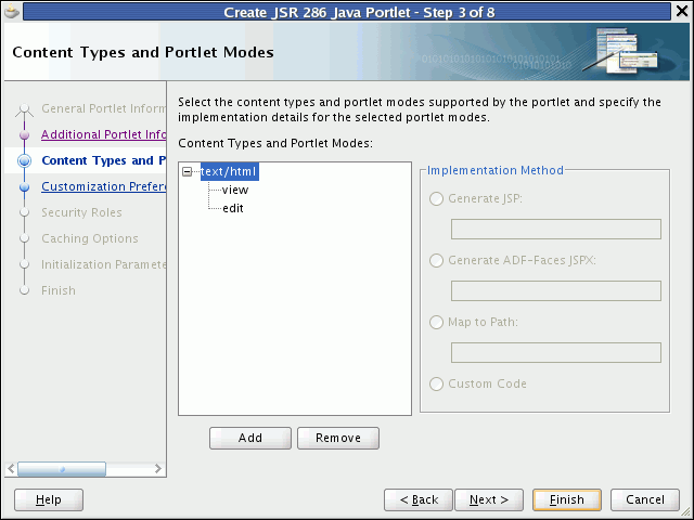

On the Content Types and Portlet Modes page (Figure 55-5), in the Content Types and Portlet Modes list, select view.
Figure 55-5 The Content Types and Portlet Modes Page
In the Implementation Method section, select how you want to implement View mode for your portlet (for more information about View mode, see Section 53.1.3.1, "View Mode"):

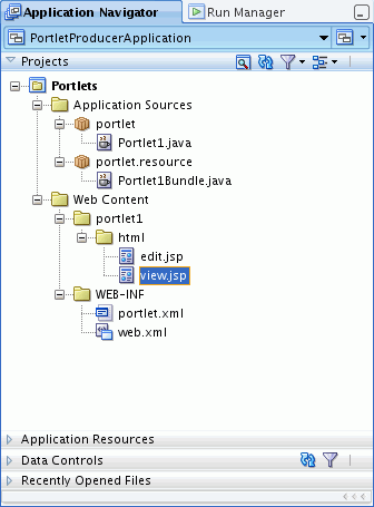

Select Generate JSP to generate a skeleton JSP file for the portlet mode. Enter a name for the JSP in the corresponding field, or accept the default.
When you complete the wizard, the generated JSP displays in the Application Navigator where you can select it for further development. This is the default selection for all portlet display modes.
Select Generate ADF-Faces JSPX to generate a page to which you can add ADF-Faces components. Enter a name for the JSPX in the corresponding field, or accept the default.
 Note: If you choose this option, the portlet implementation class is created as a subclass oforacle.portlet.bridge.adf.application.ADFBridgePortlet, instead of as a subclass of javax.portlet.GenericPortlet. That is, the wizard generates a portlet application which uses the Oracle JSF Portlet Bridge. For more information about the Oracle JSF Portlet Bridge, see Chapter 54, "Creating Portlets with the Oracle JSF Portlet Bridge." |
Select Map to Path to map the portlet mode to a web resource in the portlet application, such as a page. The resource is not generated by the wizard. Enter the name and path in the corresponding field. You can create this resource after completing the wizard if necessary.
With this selection, you must write the targeted resource or file yourself. The target could be, for example, a JSP, a servlet, or an HTML file. This selection enters code in the generated portlet Java class that routes requests for the given mode to the specified target.
Select Custom Code to implement the portlet mode through a custom coded object. You must create this object later. This selection generates a skeleton method to render content (private void doMODE_NAMECONTENT_TYPE) in the generated portlet java class. You must update this code to render useful content.
 Note: If you want this portlet mode to support a different content type, for example text/xml, see Step 17. |
If you selected Enable users to edit portlet content on the first page of the wizard, select edit and then select the implementation method for Edit mode (for information about Edit mode, see Section 53.1.3.2, "Edit Mode").
To implement another portlet mode for your portlet:
In the Content Types and Portlet Modes list, select an existing mode (for example, view) under the appropriate content type (for example, text/html).
Click Add.
In the Portlet Modes dialog, move the required modes to the Selected list and click OK.
The Portlet Modes dialog lists the standard modes supported by JSR 286 and the extended modes supported by WebCenter.
For more information, see Section 53.1.3, "Portlet Modes."
Select each of the portlet modes and specify the implementation method to use for rendering content, as described in step 14.
To add a new content type:
In the Content Types and Portlet Modes list, select an existing content type (for example, text/html).
Click Add.
In the Content Types dialog, move the required content types to the Selected list and click OK.
Click Next.

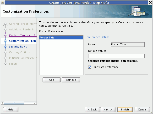

On the Customization Preferences page (Figure 55-6), click Add to add a new customization preference to the portlet.
By default, the wizard includes a customization preference to enable users to customize the portlet title.
Figure 55-6 The Customization Preferences Page
In the Add New Preference dialog, in the Name field, enter a name for the new preference.
The name must be unique in the portlet. Use only letters, numbers, and the underscore character.
In the Default Values field, enter one or more default values for the new preference. Separate multiple values with commas.
To make the preferences translatable, select the Translate Preference checkbox and then click OK.
JDeveloper generates a resource bundle class for translatable preferences, with strings for which you can obtain translations. At runtime, the portlet references the resource bundle entries.
 Note: The preference name is always translated, but there is not always a requirement to translate the default values. For example, if the value is an integer, then no translation is needed. |
Repeat the preceding steps to add more preferences. When you are done click Next.

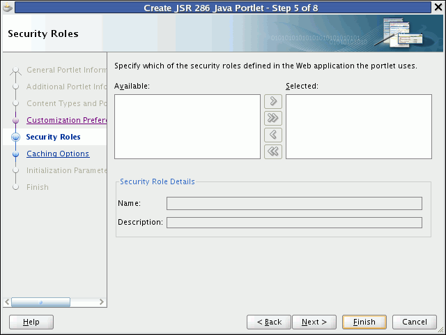

On the Security Roles page (Figure 55-7), to add an existing security role to your portlet, select the security role and move it to the Selected list.
Security roles enable you to set tiered levels of access to the portlet. For example, a View user can view the portlet but cannot edit it; a Customize user can customize portlet settings; a Manage user can perform all available functions associated with the portlet.
The Available list displays the security roles defined for the application in which you are creating the portlet. Moving a security role to the Selected list creates a reference of the security role in the application's portlet deployment file (portlet.xml) that refers to the security role in the application's web deployment file (web.xml).
You can create new security roles for the application by editing web.xml. For more information, see the JDeveloper online help.
Click Next.

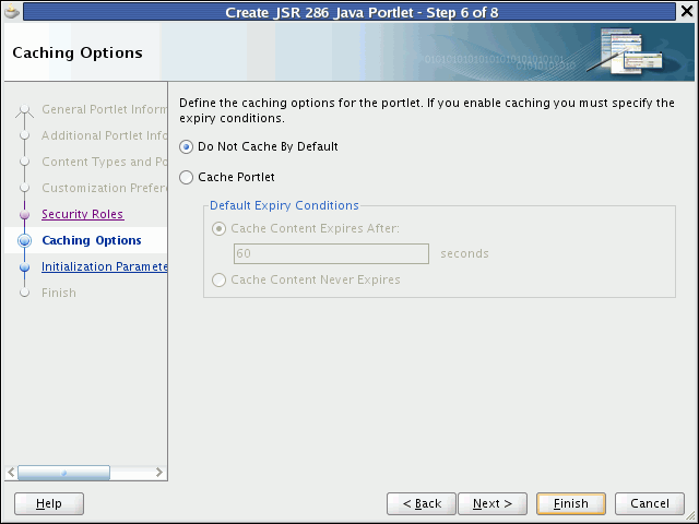

On the Caching Options page (Figure 55-8), select Cache Portlet to enable expiry-based caching for your portlet.
Selecting this option indicates that portlet caching is managed by the portlet container. The portlet itself may choose to cache content for any given response. The settings on this page apply only when the portlet itself does not specify a caching condition for a response.
If you do not want any default caching for this portlet, choose Do Not Cache By Default. In this case, the wizard actually sets a cache duration of 0 seconds. As stated earlier, this cache setting only comes into play when the portlet itself does not specify a caching condition for a response.
If you choose no caching here and you later decide to implement default caching for the portlet, then you can change the cache duration value in the portlet.xml file, which is generated by the wizard, to a number greater than zero.
For more information, see Section 56.2.9.1, "Implementing Expiry-Based Caching."
For information about how to implement validation-based caching, see Section 56.2.9.2, "Implementing Validation-Based Caching."
If you chose to cache the portlet, in the Default Expiry Conditions section, select:
Cache Content Expires After [ ] seconds to expire the cached portlet content after a certain amount of time. Specify the time limit in the corresponding field.
Cache Content Never Expires to never expire the cached portlet content. You may want to select this option if the portlet contains static content that is unlikely to change.

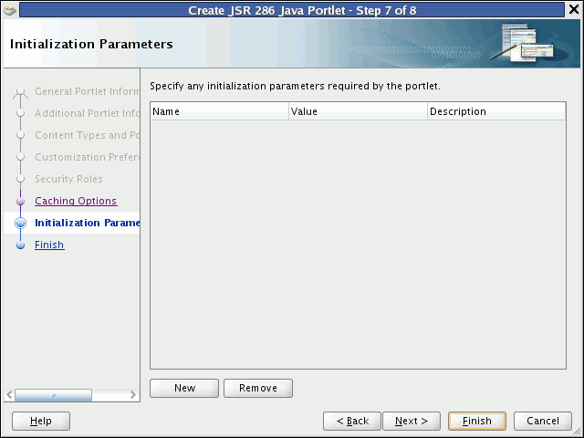

On the Initialization Parameters page (Figure 55-9), you can add initialization parameters to your portlet.
Initialization parameters provide the application developer, who decides what goes into the .war file, an alternative to JNDI variables for configuring the behavior of all of the different components of the application (for example, servlets and portlets) in a compatible way. These initialization parameters are added to the portlet.xml file.
Click New to add a new initialization parameter to the portlet.
In the newly added row, double-click each field to provide a Name, default Value, and Description for the parameter.
Repeat these steps to add more initialization parameters.
When you are done, click Finish.
Figure 55-9 The Initialization Parameters Page
When you use the JDeveloper wizard to create a JSR 286 Java portlet, JDeveloper generates a default implementation of the portlet. Specifically, the following files are created:
Two Java classes:
portletName.java is invoked by the portlet container and contains all the methods required by the portlet standards.
portletnameBundle.java contains all the translation strings for the portlet.
portlet.xml is the portlet deployment descriptor file for the application.
web.xml is the web deployment descriptor file for the application.
Files for each portlet mode you selected for the portlet:
If you selected Generate JSP for the portlet mode, a JSP page is created for the mode, for example, view.jsp.
If you selected Generate ADF-Faces JSPX, a JSPX page is created for the mode, for example, view.jspx. You can add Faces components to this page.
If you selected Map to Path, no additional files are created as the code for the portlet mode resides in an existing resource. Code is added to the portlet's Java class to route requests to the specified target.
If you selected Custom Code, no additional files are created, but the code for the portlet mode resides in the portlet's Java class.
You can see all these files in the Application Navigator, as shown in Figure 55-10.
Figure 55-10 Files Generated for a JSR 286 Java Portlet
The next step is to extend the sample code with your own business logic to implement the desired functionality and features for your portlet. For more information, see the JSR 286 specification at:

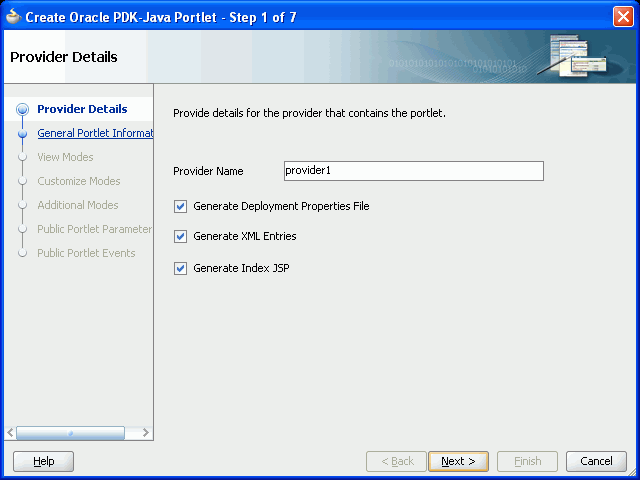

On the Provider Details page of the Create Oracle PDK-Java Portlet wizard (Figure 55-11), enter a name for the new producer to contain your portlet. This name must be unique within the project.
In the PDK-Java, the term provider is used instead of producer. A provider is the same thing as a producer.
Select Generate Deployment Properties File.
This automatically generates two .properties files:
serviceID.properties defines properties for a producer with that service ID. The service ID has the same value as the producer name.
_default.properties is a default properties file. A producer application may have multiple producers, each with its own service ID. On registration, if no service ID is defined, then the default properties file is used.
Select Generate XML Entries.
This automatically generates a producer definition file (provider.xml) for the producer that contains details of the portlets belonging to the producer, including those generated by the wizard.
Select Generate Index JSP and then click Next.
This automatically generates an index.jsp file that lists all the producers that reside in the application with hyperlinks that enable easy access to producer test pages.

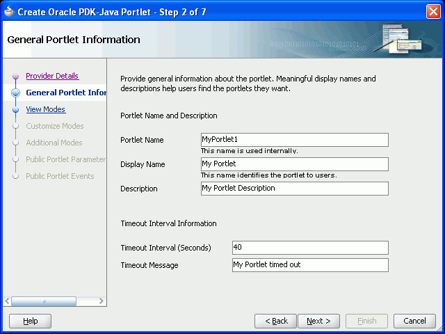

On the General Portlet Information page (Figure 55-12), enter a name and display name for your portlet.
The name is used internally and is not exposed to users. The display name is displayed to users in portlet selection lists, such as the Component Palette.
The description is not implemented in WebCenter Portal applications so you do not need to enter a value in this field unless your portlet is likely to be consumed by other applications, such as Oracle Portal.
Figure 55-12 The General Portlet Information Page
In the Timeout Interval (Seconds) field, enter the number of seconds to allow for rendering the portlet.
In the Timeout Message field, enter a message to display if the rendering of the portlet exceeds the timeout interval specified and then click Next.
On the View Modes page (Figure 55-13), under Show Page, from the Implementation Style dropdown list, select the implementation style to use for the portlet's Shared Screen mode.
Select JSP to implement the portlet's Shared Screen mode as a JavaServer Page. In the File Name field, enter the name of the file to be generated by the wizard.
Select HTTP Servlet to implement the portlet's Shared Screen mode as an HTTP servlet. In the Package Name field, enter the name of the package that contains the HTTP servlet. In the Class Name field, enter the Java class to be referenced with the portlet's Shared Screen mode.
Select HTML File to implement the portlet's Shared Screen mode as an HTML file. In the File Name field, enter the name of the file to be generated by the wizard. Note that, when you choose HTML File, the following code is added inside the <renderer> element of your provider.xml file:
<showPage class="oracle.portal.provider.v2.render.http.ResourceRenderer">
    <resourcePath>provider_id/portlet_name/file.html</resourcePath>
    <contentType>content_type</contentType>
    <charSet>char_set</charSet>
 </showPage>
charSet indicates the character set that the producer must use to encode the HTML page. The default character set is determined by JDeveloper preferences. If you require a different character set, you must update this element of provider.xml accordingly.
Select Java Class to implement the portlet's Shared Screen mode as a Java class. In the Package Name field, enter the name of the package that contains the Java class. In the Class Name field, enter the name of the Java class.
For more information about Shared Screen mode, see Section 53.1.3.1, "View Mode."
To implement Full Screen mode for your portlet, select Show Details Page and then select an implementation style as described for Full Screen mode in step 11.
For more information about Full Screen mode, see Section 53.1.3.7, "Full Screen Mode (PDK-Java)."

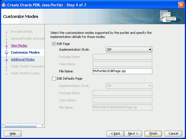

On the Customize Modes page (Figure 55-14), Edit Page is selected by default. To implement Edit mode for your portlet, select an implementation style as described for Shared Screen mode in step 11. If you do not want to implement Edit mode, then deselect Edit Page.
For more information about Edit mode, see Section 53.1.3.2, "Edit Mode."
To implement Edit Defaults mode for your portlet, select Edit Defaults Page, and then select an implementation style as described for Shared Screen mode in step 11.
For more information about Edit Defaults mode, see Section 53.1.3.3, "Edit Defaults Mode."
Click Next.

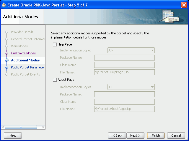

On the Additional Modes page (Figure 55-15), to implement Help mode for your portlet, select Help Page, and then select an implementation style as described for Shared Screen mode in step 11.
For more information about Help mode, see Section 53.1.3.4, "Help Mode."
To implement About mode for your portlet, select About Page, and then select an implementation style as described for Shared Screen mode in step 11.
For more information about About mode, see Section 53.1.3.5, "About Mode."
Click Next.

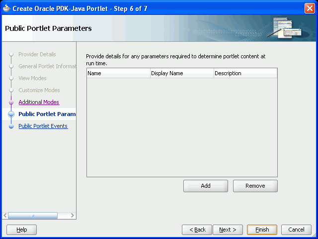

On the Public Portlet Parameters page (Figure 55-16), click Add to add a public parameter to your portlet.
This adds a new row to the table of parameters. Double-click each field in the row to provide a name, display name, and description for the parameter.
Repeat this step to add more public parameters. When you are done, click Next.
Public portlet parameters enable a portlet to communicate with the page on which it resides and with other portlets on that page. For more information, see Section 56.3.3, "How to Implement Public Parameters."
Figure 55-16 The Public Portlet Parameters Page
Oracle PDK-Java events are not supported in WebCenter Portal applications, so On the Public Portlets Events page, click Finish.

When you use the JDeveloper wizard to create a PDK-Java portlet, JDeveloper generates a default implementation of the portlet. Specifically, the following files are created:
Files for each portlet mode you selected, for example portletnameEditPage.jsp.
provider.xml is the producer definition file that contains details of the portlets belonging to the producer.
web.xml is the web deployment file for the application.
weblogic.xml includes a shared library definition pointing to the PDK-Java shared library.
index.jsp is used by JDeveloper for testing purposes.
_default.properties is the default properties file.
serviceID.properties is the properties file for the producer identified by serviceID.
All these files are required to deploy and run the portlet successfully, except for index.jsp.
You can see all these files in the Application Navigator, as shown in Figure 55-17.
Figure 55-17 Files Generated for a PDK-Java Portlet
