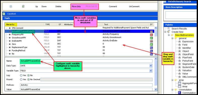

  3. Make sure the SearchPalette window is open. It contains a list of math variables that can be dragged and dropped onto the screen. If this window is not open, click Window on the Main Menu and select Open Search Palette Window.
  4. Drag the type of math variable needed from the Palette window to the Configuration Area.
  1. Depending on the type of math variable selected there will be various operations, behaviors and characteristics defined. The following are required:
Note: The scroll bar for the Math pane is hidden from view. To scroll to the bottom of the Math Pane, click the scroll bar at the bottom of the window and drag it to the right. This will reveal the vertical scroll bar used to move to the bottom of the Math Pane.
  1. Move the math variables in the hierarchy using the Up or Down buttons at the top of the Configuration Area.
  2. Create or delete math folder structures by using the Move Into and Move Out Of buttons at the top of the Configuration Area. Move Into means that a math variable will be moved inside a MathLoop or MathIF. Move Out Of means that a math variable will be moved outside and above the MathLoop or MathIF that it is currently inside.

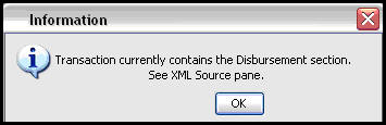

Note: When checking-out a transaction that contains a Disbursement section, a pop-up notification will display indicating that there is a Disbursement section in the transaction and that the XML Source pane should be used to edit that section. When the XML Source pane is open, scroll to the Disbursement section and make the changes. Check the transaction back in to save the changes.
Disbursement section message
Disbursement Message
