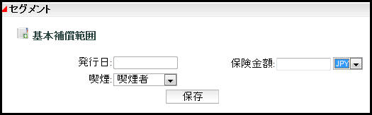

  4. Select Base Coverage from the Segment drop down box.
  5. Enter the Sum Assured amount and select a currency code. This is the death benefit. This amount is also used when calculating the monthly charge for the policy.
  6.
    Note: If a currency is not selected, then the plan currency will be assigned to the Sum Assured value. If a currency is selected, then a currency conversion will take place via a Function in the math, to convert the currency to the base currency when monthly charges need to be calculated.
  7. Select a Tobacco Use category from the drop down box. OIPA will check the rate table for the category assigned to determine the monthly charge for the policy.
  8. Click Save.
