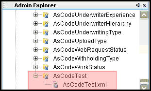

New code name wizard at Step 1 New Code Wizard
By default, the new code name will be checked-in. Check it out in order to edit it.
Code folder structure showing newly created code file
New Code Displayed Under Code Names Node

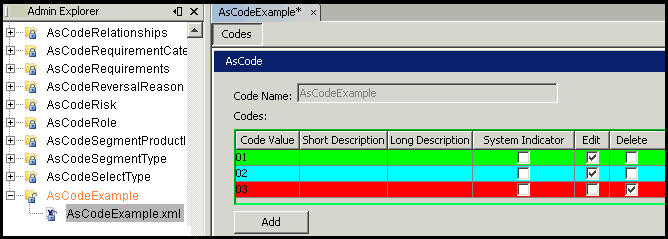

Edit
Selecting this checkbox allows a code to be edited within a particular code name. When a new code is added, the edit checkbox defaults to checked and the code will appear highlighted in blue. If the Edit checkbox is selected on an existing (not new) code, it will become highlighted in green.
Delete
Selecting this checkbox allows a code to be deleted from the particular code name that is checked out. This code will become highlighted in red when the checkbox is selected.
Add
The Add button allows a new code to be added to the particular code name that is checked-out. When a new code is added, a new code line will appear in the codes pane and it will be highlighted in blue with the Edit checkbox defaulting to checked.
Color Coding
The code-editing functionality uses the following color coding (highlighting) to identify the status of a particular code in a code name.
Code
Task
Green
Edit an existing code (not new).
Blue
Add a new code and edit while new.
Red
Delete a code.
As Code file displaying different color scheme options.
Code Color Scheme

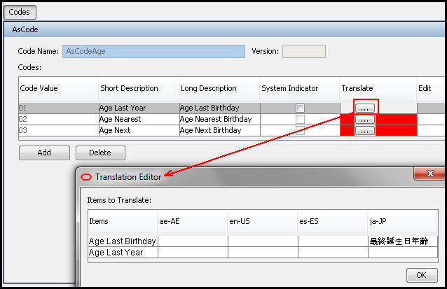

Updating Translation Values when Codes are Edited
A translation button is available on each row to allow easy access to the Translation editor. Click the node in the row to open the translation values for the Short and Long Descriptions of the code. Make any changes and click OK to close the window and save the changes.
If changes are checked in for a code in AsCode and the translation node is not clicked, then the Rules Palette will open the Translation Editor window so that translation values can be updated if needed. Update any values and click OK to save the changes.
Deleting code values does not remove the translation value.
Translation node and Translation Editor
Translation Button and Translation Editor Window
